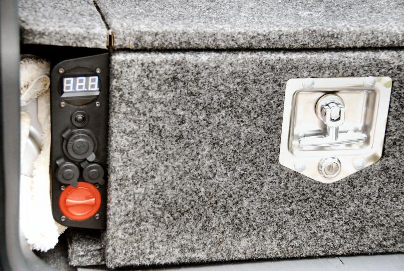

    Hey people newbie to this site question wanting to put power board in back compartment of 120 Prado thinking of putting baintech flush mount system in anyone done this or got photos any help would be great.

    Yes I put this onto the rear drawers a few years ago, fed from the AGM rear battery. After a couple of years the readout screen started playing up becoming unreadable. So I ripped out the screen and stuck in a cheap volt meter but no ammeter readout. As you can see the blue numbers are hard to see in daylight. Might pay you to look at other makes.

      Don't have draws in back yet as wife still wants to have rear seats in. Santa is bringing 60l Engel so wanting to get this sorted. Maybe just put Engel plug in side panel as I'm going to make my fridge slide removable from floor ( with seats out) for holidays & camping trips.thanx 4 reply ozpat!
        I have one of these I bought from home of 12v. They have about 15 different combos of plug setups you can buy. I found the prices ranged from $40 to $90 depending on the setup.
        http://s15.postimg.org/f7muzauqz/121...43384111_n.jpg
        The Anderson is wired for a full 50 amps and the box contains a built in 15A circuit breaker for the other 2 plugs
          I put this baintech unit in a couple of years ago and it's great. When not in use its out of the way and not seen behind the cover. This particular model is discontinued but there are other combo's etc available
