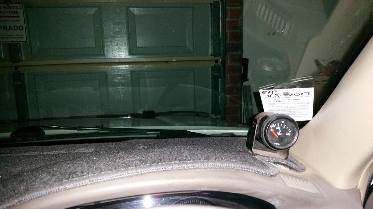

              How are you monitoring the temps of your transmission? I live in Costa Rica and often are in the mountains.
              I would like to see the temps of my engine oil and transmission. Thanks

                    Just a VDO temp gauge David
