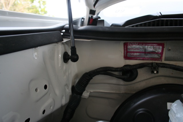

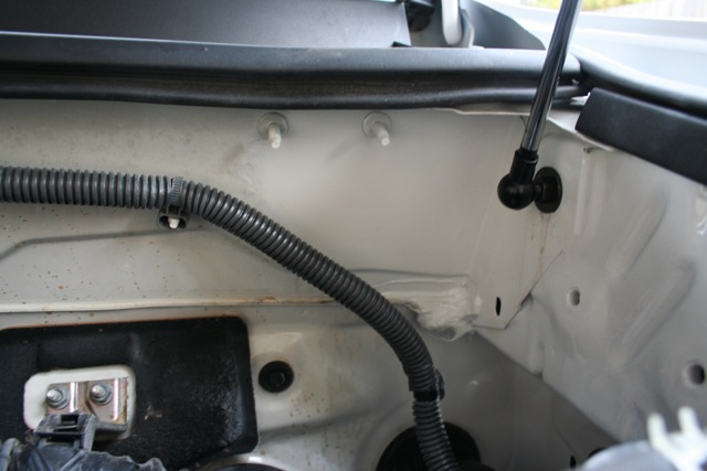

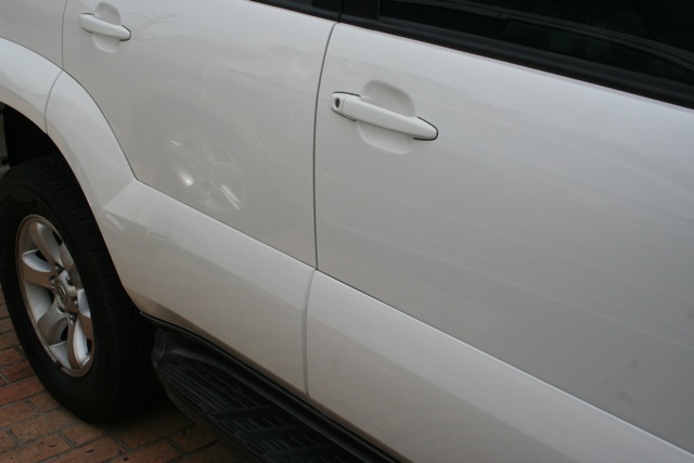

              Here are some shots of the repairs.
              After examining the photos, I am even more horrified of the repair to the engine bay section to the firewall on the driver's side. Notice the rough join of the inner guard to the section holding the strut arm, compared to the passenger's side. ALso notice the rough edge of the paint to the left of the air conditioning sticker.
              Look, I accept the car has to be repaired after an accident, but doesn't it have to end up looking like it HASN'T been in an accident?
              Not sure if you can tell the difference in the paint colour on the doors in these pics, either.

                    As for the quality of the repairs shown in the photo:
                    Matching paint is almost an art form and requires training. Good painters are able to do this easily. A person with an untrained eye should not be able to pick the difference; and if you can (as you said), then it is not good enough.
                    As for the blending I am working on memory here, block colours such as white do not have a clear coat and are generally painted to the edge of the panel. Metallic paints have a clear coat and because of this they blend the colour in the panel and paint the whole panel with the clear coat. This makes matching block colours harder.
                    Cars are now painted in 2pac. They do not fade as the old thinner based paints as used on Commodores up to and including VN's. They should not mention this as an issue.
                    I did not look, but if yours is a Grande the white is different. It is a paint with a pearl finish that changes colour in different light. I think they go from a yellow tinge at one angle to a blue tinge at another. This should not be an issue either, the colours from one panel to another still should look the same from the same angle. Good painters will be able to recreate the pearl in the paint.
                    It is hard to see but the panel job on the LHS looks okay. The problem with painting inside a engine bay, costs provided by the insurance company will not include removing the block so they are unable to remove everything prior to painting. But if they have blended the paint on the firewall over the sticker/plate and onto a dirty firewall (as it looks), this is atrocious and the paint will not stick and peel from the firewall. Painting over sticker/plates is dodgy and lazy.
                    The job on the RHS looks bad. Other than the hard paint edge that does not follow the sticker and overspray on the grommet, the actual repair looks terrible. The photo but is looks as if the panel holding the bonnet strut has been knocked around poorly, badly welded and not properly ground off and then slapped on with sealant trying to hide the poor repair.

                      I have to admit I had another look at the RHS repair under the bonnet and it doesn't look quote as bad in real life as it does in the photo. And I do accept that after a while there will be a layer of grime over this whole area, so it will look more normal. But it isn't as good as the LHS, which is clean and looks like new.
                      The rough finish near the air conditioning sticker is unacceptable, as is the fact that the firewall obviously wasn't cleaned before painting. The brown water/dirt spots you see on the firewall next to the fresh paint can be cleaned off with a simple wipe with a chamois. And why wouldn't they detail the engine bay so this was not so noticeable before delivery? Just makes it look like you have taken delivery of a fixed smashed car. There were also some marks in the paint that I had to polish out. There is also a bubble in one of the flares right next to the guard. The rubber behind each flare on the front guards is fitted differently on both sides.

                          The under bonnet repair can be easily fixed by throwing in some choice mud and letting it set for a while then hosing it out. Do this a couple of times and you will never notice the difference. Most of my under bonnet is now in a variety of orangey-brown tints to match the countryside.
                          The outside is a different story where all can see the obvious difference in paint shading. I'd take it up with the repairer first and see what he can do about it. Chances are it was a junior apprentice who did the match up. If you get no joy with this man then I would contact my insurer.
                          Most of the repairers should be using an electronic sampling system which copies the original paint. When I did a home repair on my beige 98 Prado I found over a dozen different shades of the one factory colour. You can't just rely on the paint code as per the vehicle id/compliance plate.
                          You want to see the dodgy jobs we get on our fleet vehicles of which about 90% are white. It's all a matter of get them in quick and get them out quicker.

                            Bushbasher - good advice. I had thought that after a while the difference (with some mud on it) would not be as noticeable.
                            The outside is another story and in fact where they sprayed into the door opening - where the new paint meets the old near where the door sealing rubber sits against the frame - it is blatantly obvious the paints are two completely different whites. The original has a yellow-ish tinge to it where the new is a very brilliant white.
                            The bolts that hold the new guards on have not been brush-touched after being installed, either. The job would have been more acceptable if they bad blown some of the new paint into the rear door as well. At least the difference wouldn't have been so noticeable as ending at the door edge.
