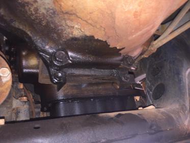

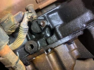

    I have a 2007 120 series D4D prado.
    Question is I have noticed an oil leak around the top of sump, rear half of block area..
    Possibly coming from this ( I assume is a crank shaft sensor BLANK!??) as it is a 1KD-FTV I believe, and their crank sensors are located elsewhere I am led to believe, so I’m assuming it’s a blank....?, Does this ‘blank’ have another name? (It’s tear drop in shape), see images attached.
    Either leaking from that or it’s a sump gasket, which sounds like a major job, as I have skid plates underneath....
    Vehicle has done 220,000kms
    thank you, any info greatly appreciated

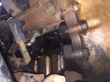

    A better image
      Try again
        A better pic
          That will be where it’s coming from. Mine did the same thing. New oring fixes it.
            ok thanks for that, hopefully it’s as simple fix as that.
            changing O ring whilst oil is drained I’m assuming??
              Don’t need to drain oil. Just undo the little bolt and pull it out. You can buy a kit from Toyota with the plug & oring or just go to a bearing shop & buy the oring.
