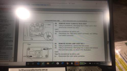

    First up this isn't about the globe replacement. This is the whole map light housing removal from the roof lining.
    I'd expect either screws or clips to be holding it in. I've popped all the covers off and can't see any screws. Then I tried the usual pull/push/lever to pop out clips but it's not budging.
    Does anyone have a link/guide of how to remove the whole housing?
    120 Grande with sunroof
    Got the answer. Need to pull down from the windscreen side, not back like I thought.
    See attached pic
      See attached pic
