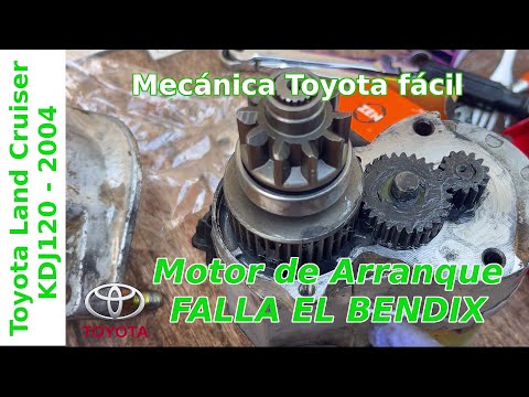

Hello, one day, I got into my Toyota and tried to start it. A very ugly noise appeared. Luckily, the next time I turned the key, the car started perfectly. However, something bad was about to happen.
In this video, I show how to fix a Bendix that doesn’t engage with the flywheel. I also demonstrate how to remove the Toyota’s starter motor and disassemble it. I explain the two most common starter motor failures and how to fix them: the Bendix failure and the failure of the automatic solenoid contacts (Click click click).
So sorry it is in perfect spanish. But hope can be useful for somebody.
Best regards.
Best regards.
