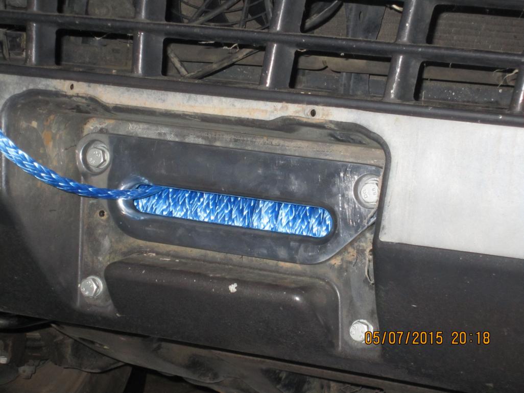

                  • ok found the solution, a 35mm offset Hawse such as this, did a quick measure and it will line perfectly.
                    http://www.4wdsupacentre.com.au/offs...ead-3337.html#
                    Tomorrows Agenda to fit the winch is back on (Photos to follow - might help someone in the future)!
                    May have to grind the bolts down a little to get the tightness, but other than that I cannot foresee any customisations to the cradle or winch at all.

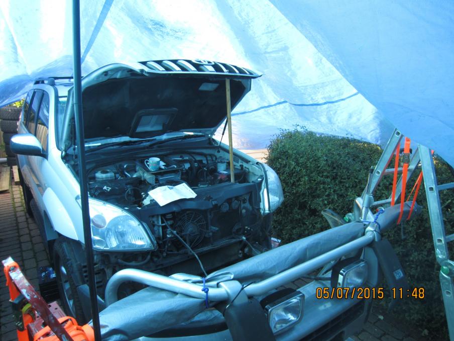

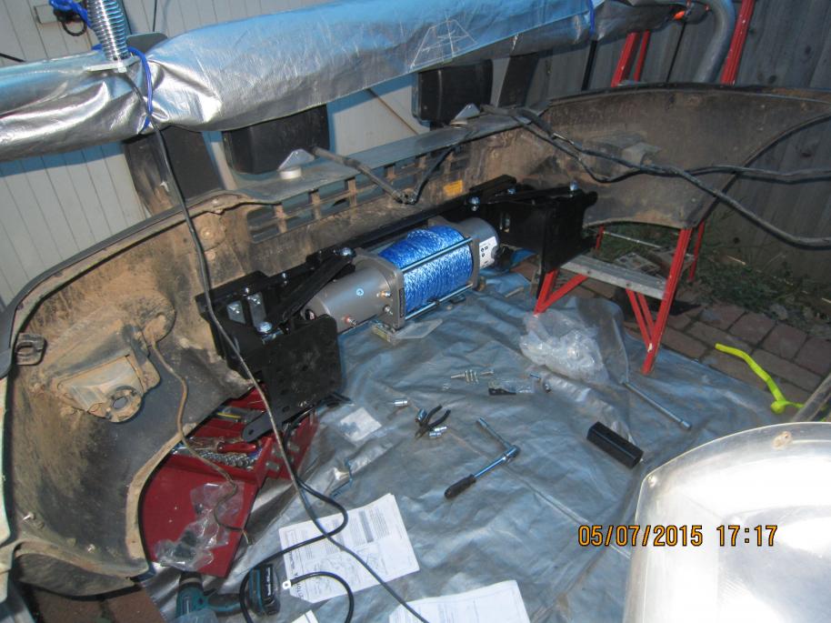

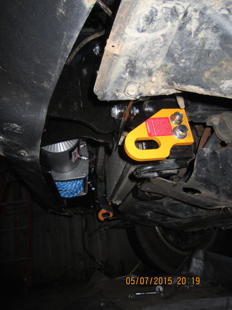

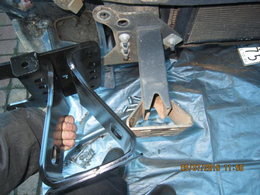

                    • Summary of Job fitting brackets/winch cradle
                      Fitted a 4wdSupacentre Grande MkIII Winch $500 to the Sovereign Bull Bar.
                      This required replacing the bull bar mounts $300 (expired recall) and adding the winch cradle $200
                      There is only one cradle available and it needs the new brackets, there two support arms from the cradle to the top of the new brackets.
                      I dont think you would want to winch using the flimsy old brackets unless you wanted to rip your bull bar clean off the car.
                      • Had to remove bull bar and old crush cans.
                      • Fitted cradle to inside of bull bar bumper
                      • Fitted the new crush cans to that
                      • Bolted in the Winch (had to shorten two of the longer supplied bolts with the angle grinder)
                      • Fitted the rest of the bull bar braces
                      • Fitted Roadsafe recovery points
                      • Mounted Bull bar back onto car
                      All up it did take me best part of the weekend, although it was a slow start with the weather.
                      The new brackets are really heavy compared to the old ones, which seem like paper.
