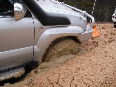

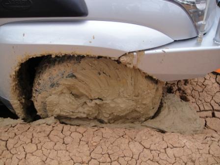

          I don't recall seeing any brackets like that before, on either of my Prados. I will be pulling my bash plates off tomorrow to remove some mud that has mysteriously got stuck up there, I will double check for you.
            Oh dear me. How on earth did you get mud there????? I mysteriously got a little on my wheels and I am now thinking I may have some under my car too ;p
ID:	635883Click image for larger version
