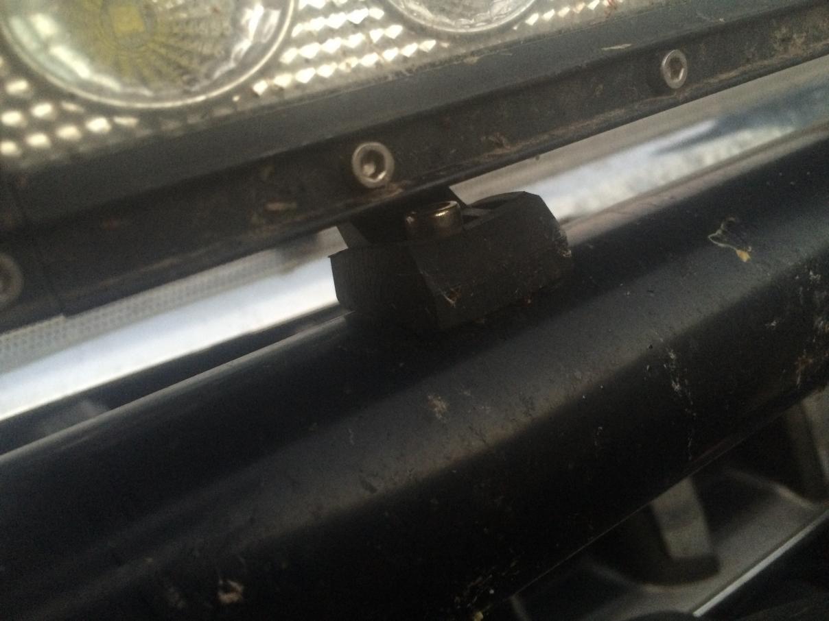

      I've got one mounted on my bullbar its a korr lighting light bar and tjm bullbar. Tjm fitted it and they have drilled into the top of the bar and tapped a thread and bolted the mounts on. Can take a photo of you need.

                    Yes, drilled into the bar. I will try to load some more pics but can't do until the weekend.
                        Not the best picture I didn't put it on so I can't give you much info but it seems to be tapped and bolted on.

                            cheers for the pictures fellas, i'm going to look at getting it drilled into the bar. For now I've used the ariel brackets facing forward it sits a little high but it does the job till i can get it drilled....
