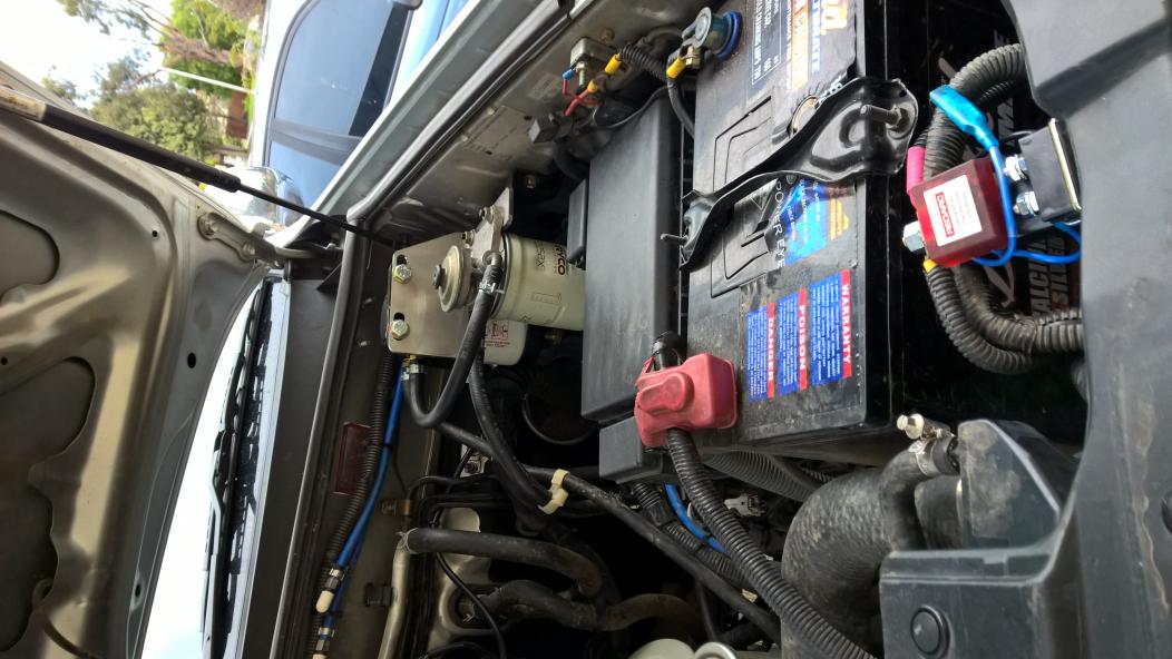

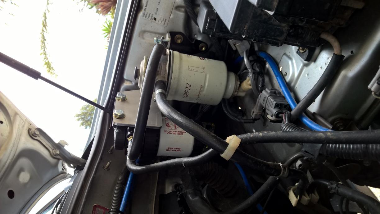

                30 micron pre 30 and the ryco 12 mircon. fits nicely

                  The Toyota filter already fitted to your Prado as standard is 11micron at 99% efficiency. This filter is both a lower micron rating and a higher efficiency than the filters you have fitted.
                          [ATTACH=CONFIG]24349[/ATTACH][ATTACH=CONFIG]24350[/ATTACH]
                          I installed an identical setup, except as per advice from Andrew Leimroth at Berrima Diesel, I hooked up the hoses differently and retained the OEM setup with water sensor as the Primary Filter and now use a 5 micron Fuel Master as the secondary (POST OEM) filtration system. The OEM setup with the Donaldson filter will separate up to 99% of any water in the fuel, therefore, should there be a significant amount of water in the fuel at some point, the OEM system will sounds the warning. The new secondary filter will take care of any finer particles left behind and (in theory) not have to deal with any water, although it has the separation bowl as additional insurance.
                          There is literally NO reduction in flow of fuel, even using the 5 micron in the secondary position.
