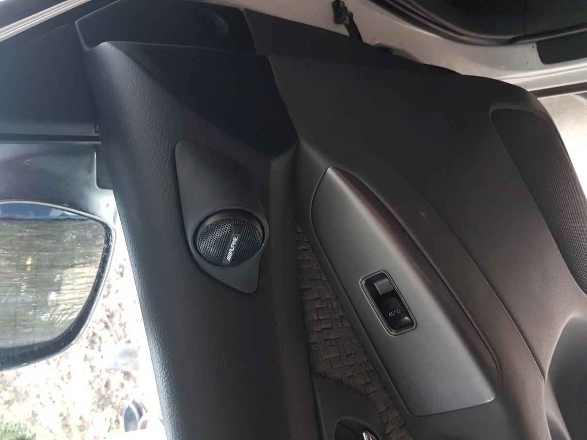

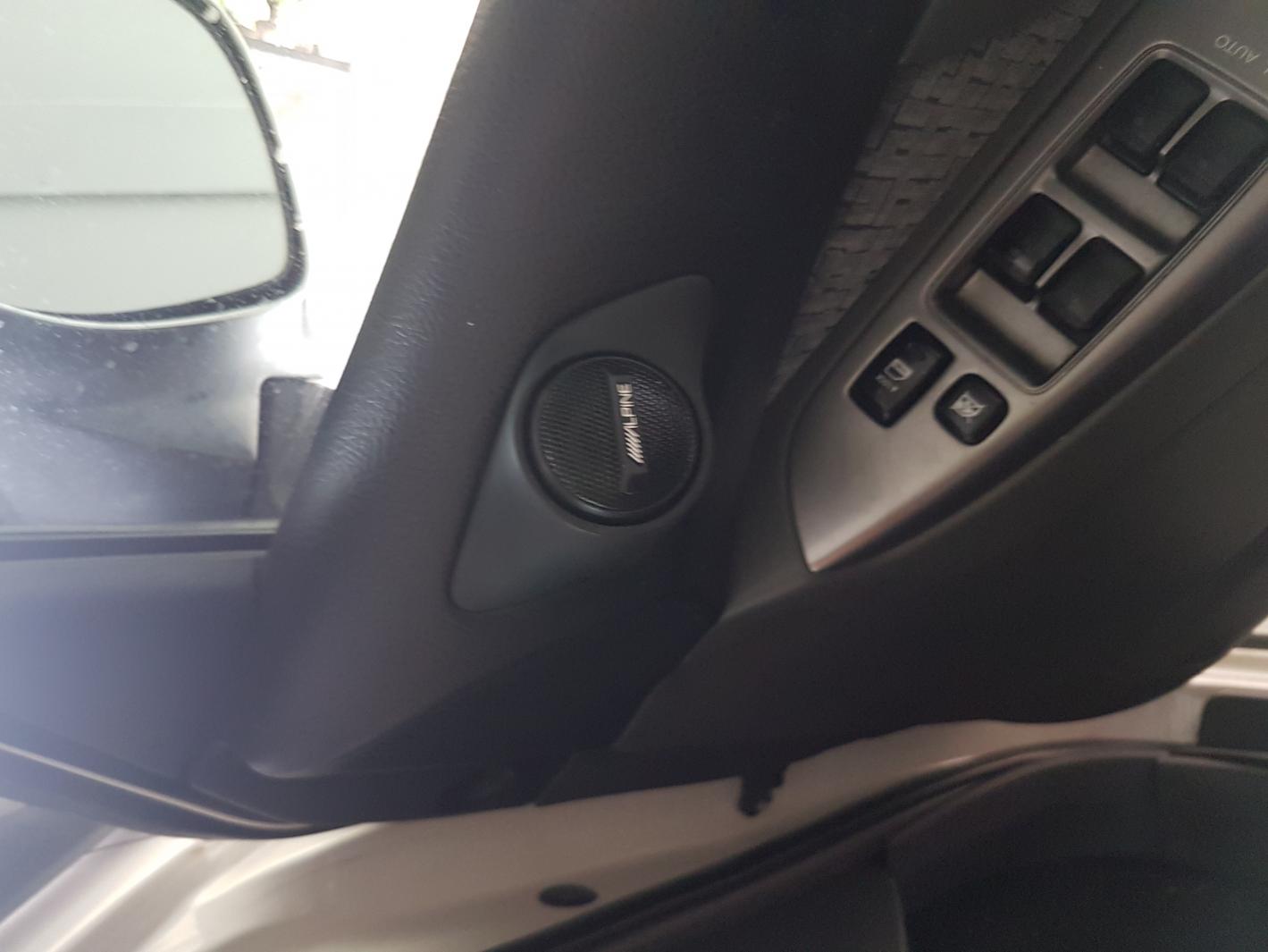

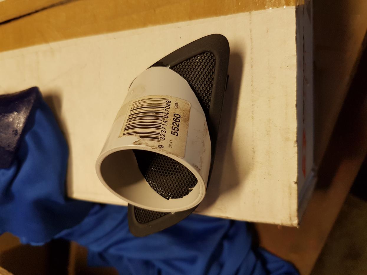

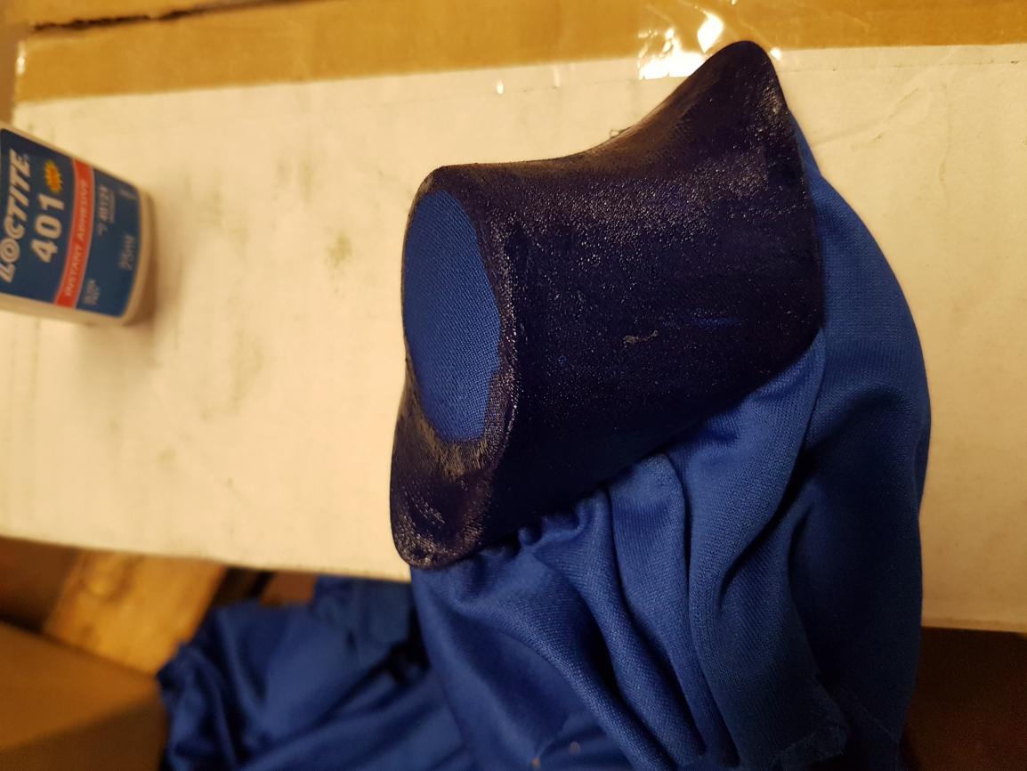

    I made up these tweeter pods Click image for larger version
ID:	662365this week. Just used the original grill with a pvc socket cut of to get the right angle then stretches some t shirt fabric over it. Then coated the whole thing in super glue. A bit of primer filler a sand and paint and I was pretty happy with the outcome.
