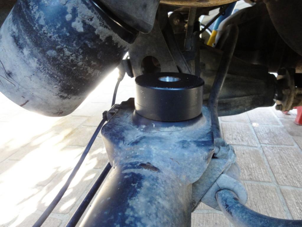

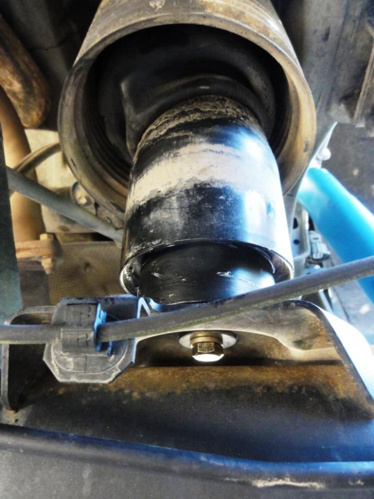

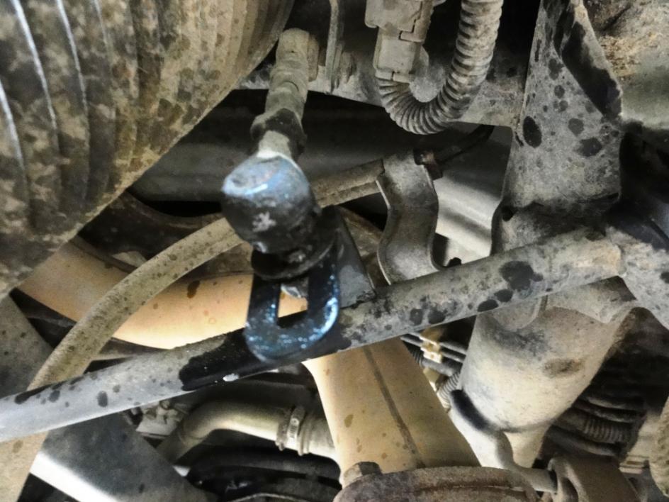

        • I seriously thought about using the R pin method for retaining the rear airbags as it looks simple and effective, however in the end I decided to make 35mm alloy spacers. My reason for this is in order to get the extra height from the airbags without the spacer they need to run higher internal pressure. I was a little worried how this would affect their longevity and their full range of travel. By using the spacers the airbags are operating much closer to the factory setup and I still have my full range of up and down travel.
ID:	640529 Click image for larger version

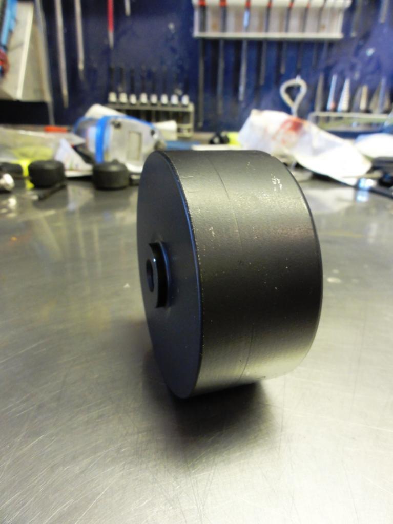

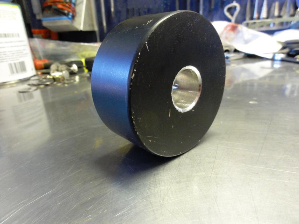

          I made the spacers from alloy approximately 75mm wide and 35mm thick, they have a raised section on the bottom to help locate them on diff and are drilled and taped so they can be bolted in place. The top part of the spacer has a 21mm hole drilled for the pin on the bottom of the airbag to sit in. All painted black so it looks almost factory

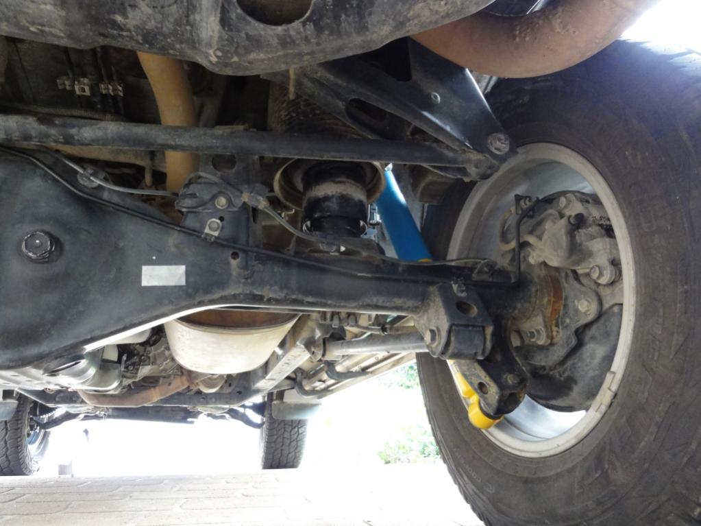

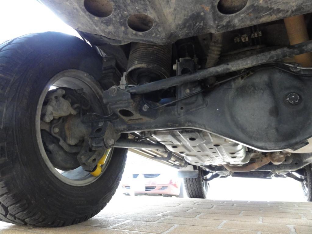

          • I adjusted the sensor fully up in its slot to give as much lift as possible.
            I then worked out that I needed 6mm spacers under the sensor bracket to give the required lift.
            All finished, almost looks factory

                • Thanks guys for the positive feedback, I made my spacers from some offcut alloy round stock. I am lucky enough to have an old lathe at work and was able to knock them up in some spare time between jobs. Any engineering shop that does lathe work would be able to quickly knock up a set. I will do a drawing with the dimensions if that helps. Out of interest I would be interested in what they would charge.

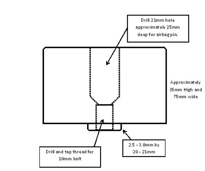

                  • Here is a rough picture of the spacers I made, sorry for the poor quality but I only had MS word to do it with. I made mine from alloy as it is light and easy to work with and won’t rust, however they could be made from many materials such as steel or stainless. The sizes are all very approximate and not critical. The most important it the hole for the airbag pin. The pin measures 20.5mm and around 20mm long. I used a 21mm drill bit and a hole depth of approximately 25mm, this gives a good firm fit but is still easily removable if need be.
                    I drilled and taped a 10mm thread on the bottom of the spacer so it could be bolted in place to stop any movement. I used a large body washer, about 25mm, a lock washer and some Loctite so it didn’t work loose. It’s a little tight but the bolt and washers can be inserted from the front of the diff with the aid of long nose plyers. Once done up nice and tight the airbag can be dropped in from the top. Fitment is as simple as that.
