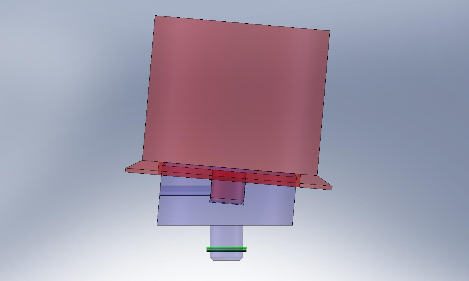

Been working on the MkII concept of the airbag spacers.
Features include:
1. Slight angle to compensate for the axle rotation due to a lift
2. Angled retaining screw for the airbag for easier installation
3. Retaining split pin added so that the spacer is 'keyed' into the airbag seat
4. Longer stub so the weight is transferred to the axle and not the airbag seat which might be the cause of collapsed driver's side airbag seat.
This is still a concept as I still need to discuss it with the machinist as to how this can be made at a good price.
Nice concept Andrew. I think having the pin keyed will be the main fix to reducing stress on the airbag and diff mount. Being able to tilt when the diff articulates as opposed to previously being fixed by a bolt should remedy the issue. Tilting the angle of the spacer will be bonus to assist also.
Sent from my iPhone using Tapatalk2004 V6 Grande. BLACK -

The spacer should also aid in going for longer shocks and/or higher lift. Also it would be nice to correct the angle the airbag is sitting currently so I'll still probably add this to the Airbagman airbags.
Someone has emailed me wanting some spacers as he found the ride to be better when set at the Low position. His theory was that at the normal position, the airbags have more air and therefore, stiffer ride. He is running Airbagman airbags already.
I've just got pricing for the Mk2 spacers and they are more than I expected at $150 a set but I guess there are more processes involved. Are there still any takers for these ones?
I have a definite from our cousin across the Pacific so far.Last edited by amts; 03-04-2013, 12:10 PM.
