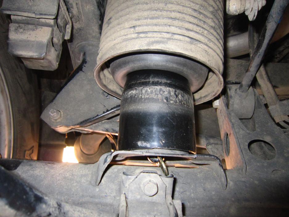

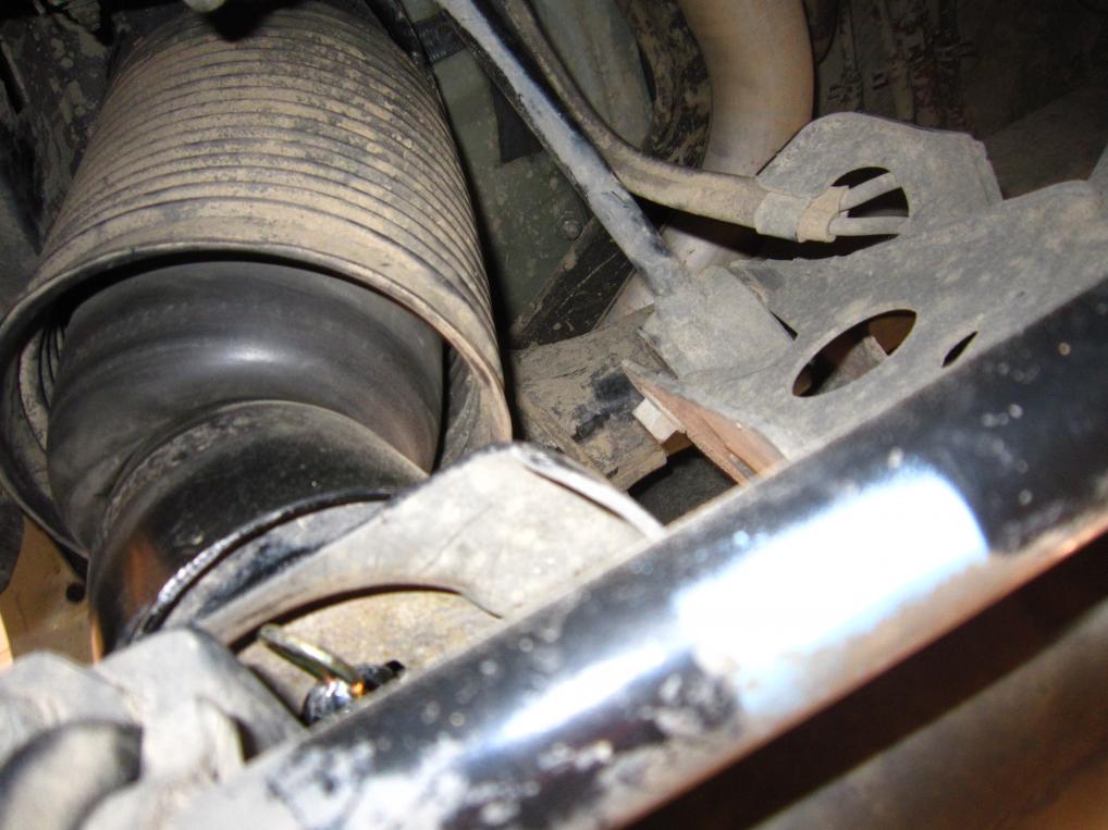

    I decided to test the airbags using my standard articulation test and found that while it didn't look pretty, the R pin did the job as intended.

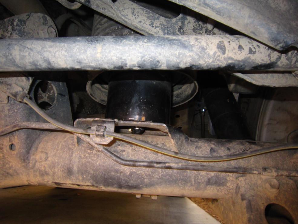

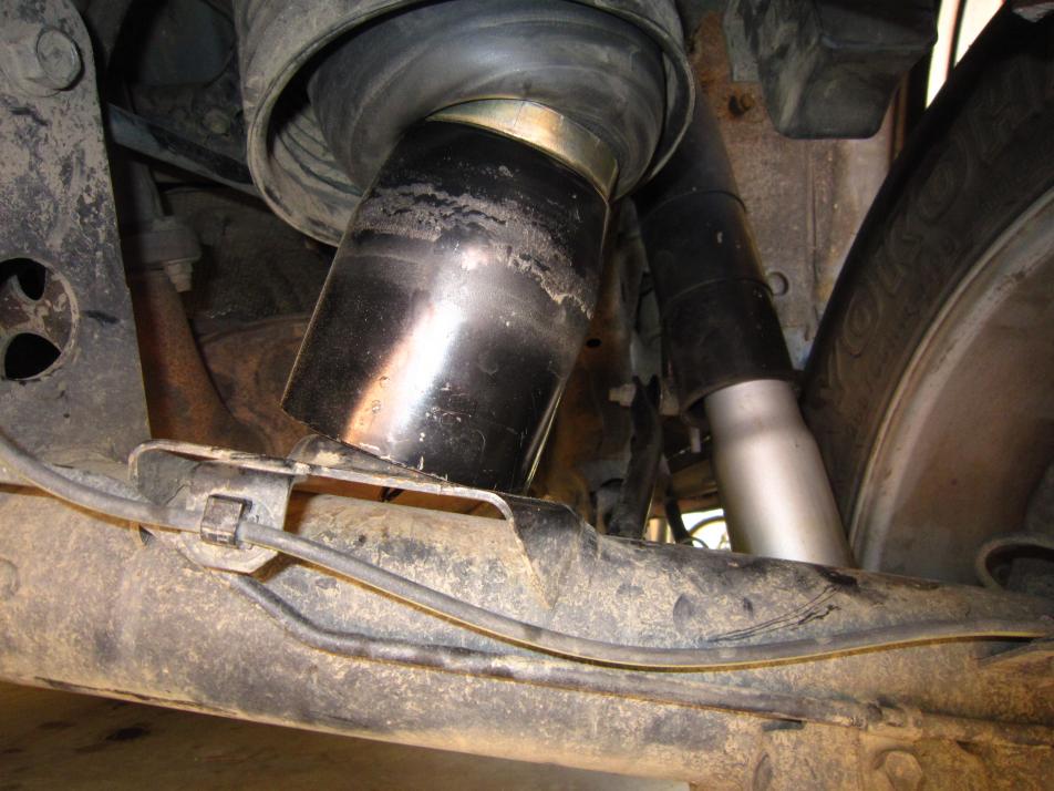

    Back on level ground, the airbag repositioned itself.

    If the airbag was welded in place at the base, then this movement would be eliminated. However, I believe that eliminating the flex at the base of the airbag could transmit that flex to the top of the airbag where the retaining clip is not as robust as an R clip. This and the fact that the OE airbag is still easily removable to upgrade to longer aftermarket airbags makes the R clip the best solution on a budget.

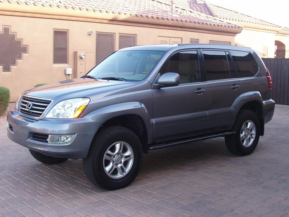

              Howdy Friends Across the pond,

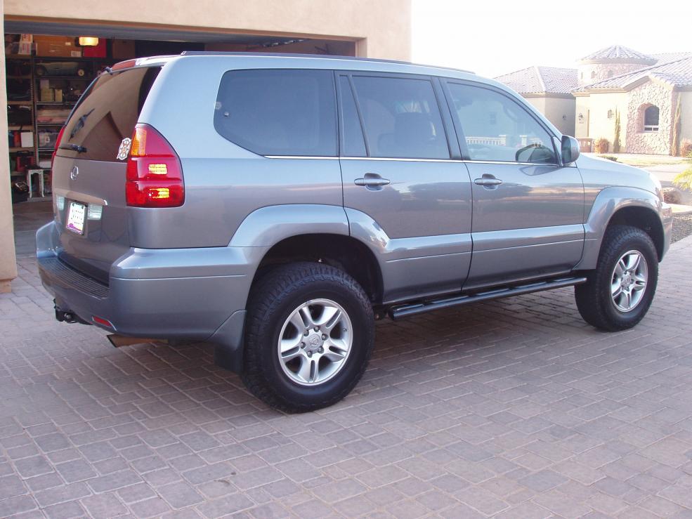

              I am about to lift my Lexus GX470. I am going with the extended travel shock option(with new UCAs) and needed to add some length to my rear airbags. A US company is starting to produce a spacer for the rear bags. I will post up mine when I get it installed next week. I do believe that they are also selling them in you area.
              I just installed 255/75/17 tires on the old girl and she need a little more room.
              TexGX
              TexGX
              04 Lexus GX470 KDSS

                  Yes the airbags are exactly the same and the 2004 GX does not have a pin to hold the bags on. I ended up just adding spacers to the ride hight sensor like others in this tread. The company making the spacers did not get them to us in time. I may add them at a later date. I did put the extended travel shock on, so will add the pin soon. I added 2.5 inches in the front and leveled the back to match. I am running 255/75/17 Hankook ATM's.

                      I believe the spacers were under $200. I was told that I could not get mine as they were all shipped to your neck of the woods. I like the spacer idea over what I did because the bags have more air in them which means they are rougher. The spacers would solve this problem.
