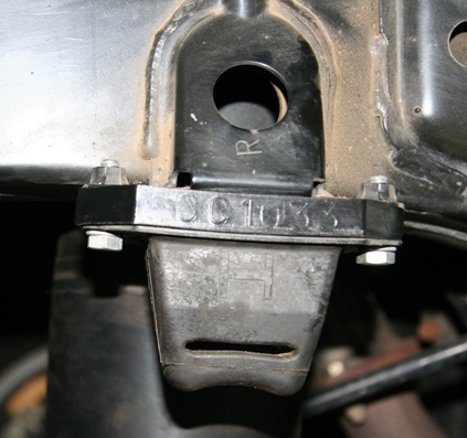

      I think the superior engineering links are the ones smakb has on his 150 and by all accounts they do the job allowing extra drop for the rear suspension. I made mini drop boxes (I will find the post and let you know tomorrow) and they are 47mm extra. If I made them again I would only make the extra drop 40mm, I have a 50mm lift with appropriate TD shocks/springs in the rear and with one rear wheel off the ground it is all good. My only problem is the sway bar link is very close to the lower control arm on full extension.

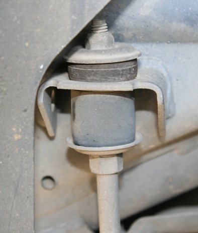

          If you look at the sway bar there is a lot of spare thread left. If you remove the nut and fit a nut then washer right down the end of thread you can add about 20-25mm. There is still enough thread left to hold the top nut in place. This is enough to straighten the swaybar on a 50mm lift.

            The other thing I just thought of is that you might not be able to lock the top nut as it screws down to the bottom of the thread and the top rubber would also be on the threaded part of the rod witch may chew it out over time.
            As AMTS also mentioned: "The nut needs to screw down to the shoulder of the thread to get the right amount of compression on the rubbers."

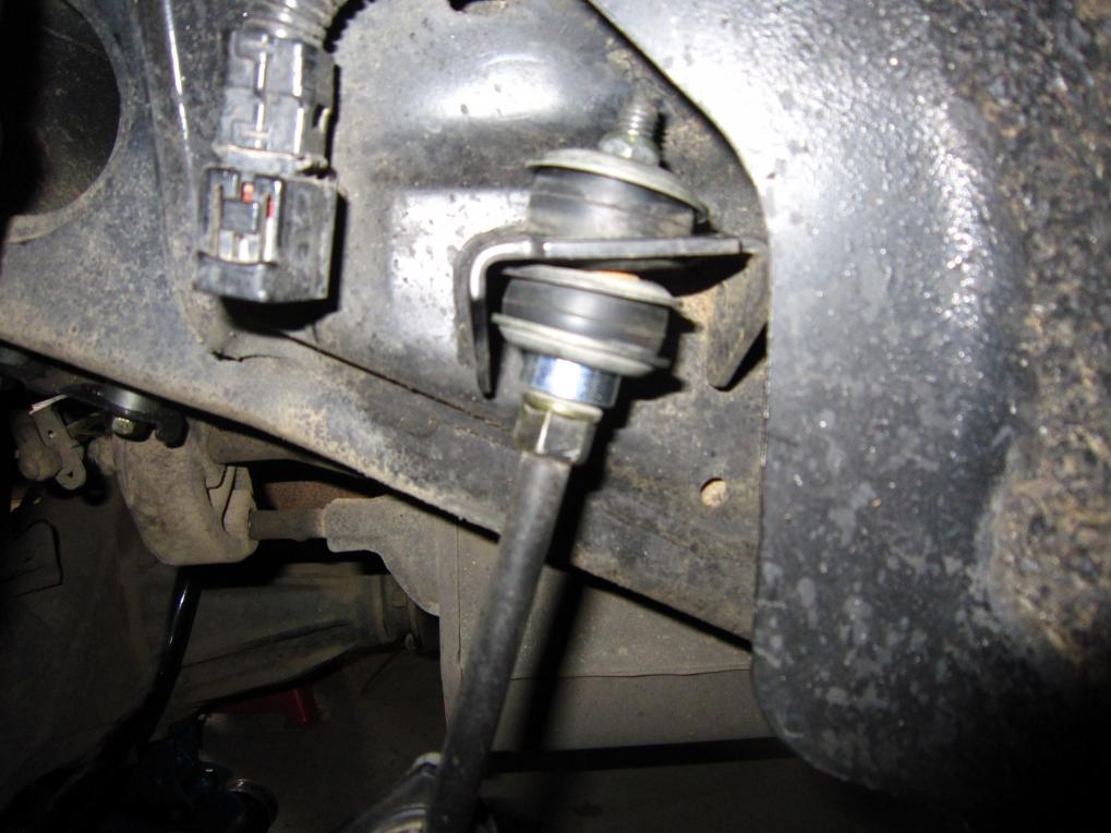

              As I mentioned earlier, on a 120 Prado you only need to extend the rear swaybar mount by 10mm to allow for shock lengths of up to 625mm extended. The standard 120 shock measures 575mm extended and the longest non-custom shock available off the shelf is the Toughdog BM401111 at 622mm extended, which is actually an 80 series Landcruiser shock that Toughdog also use on the 150 Prado. If you want to fit longer shocks, then you also need extended brake lines, extended bump stops and spring retainers. Unless you go the whole hog, then a 40mm+ sway bar extension is probably overkill.
              The Air Bag Man does a 10mm longer rear sway bar bush as well as bumpstop spacers:

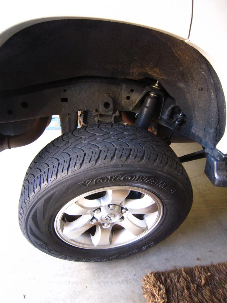

              I used a simple 7mm spacer under the lower sway bar bush and 618mm long rear shocks to achieve 930mm rear droop and good flex. In the photo, the rear wheel is still on the ground:
