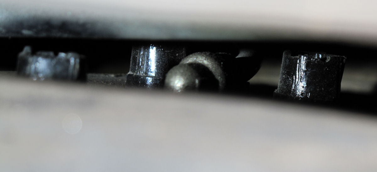

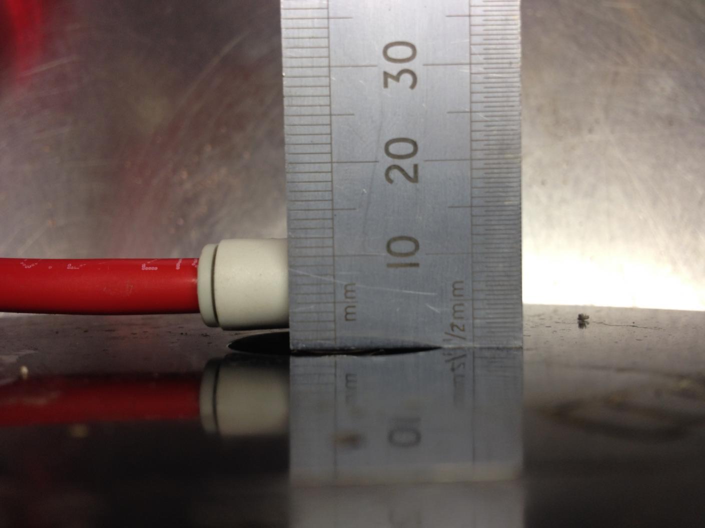

Best I could do but you can see I have tons of clearance and my fitting look smaller

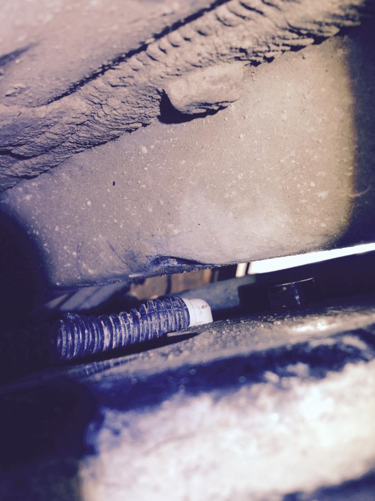

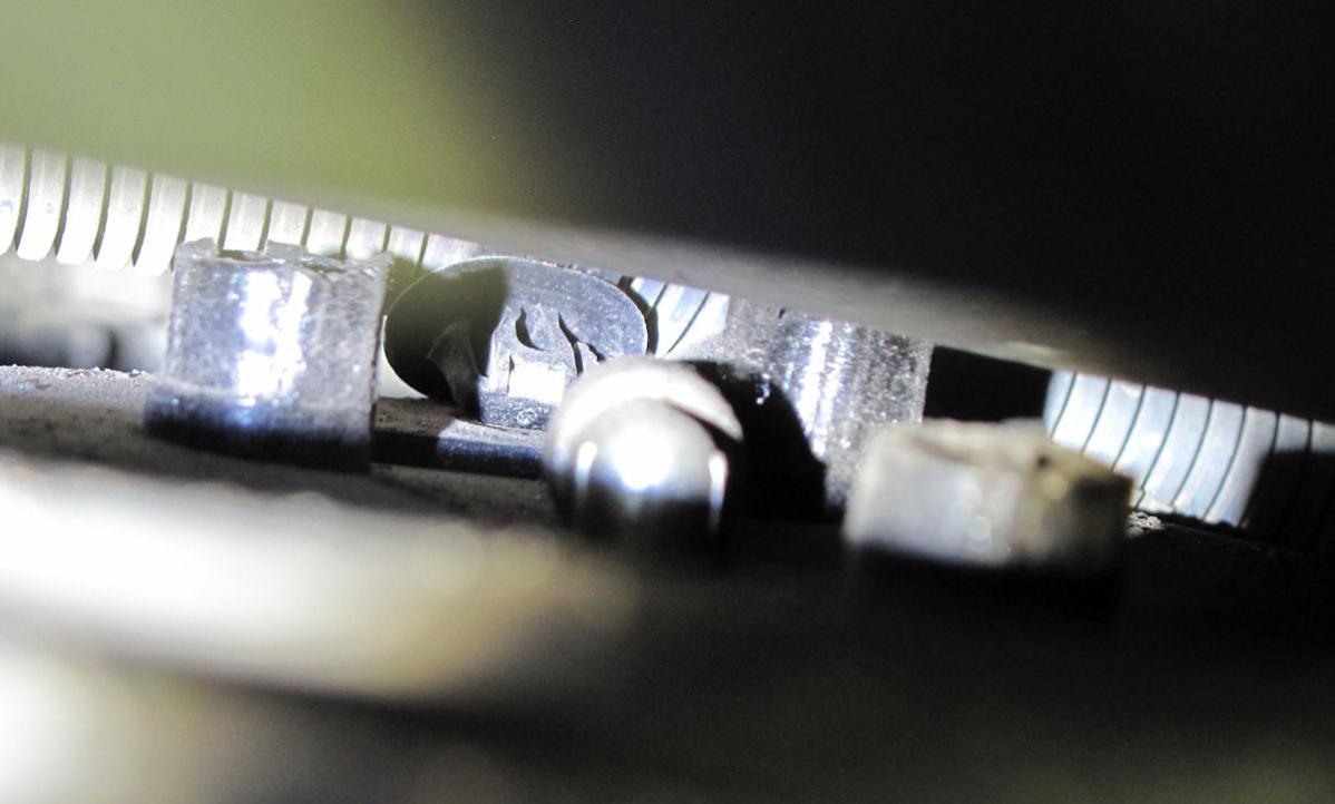

The floor is fine, I recently had the rear carpet out after a water leak and every thing was normal. The bit that was making contact was the reinforcing rib, roughly 50mm square which runs forward to back. It appears to to also be fine with no evidence of distortion. I have been all over this car and have never seen any evidence of accident damage which could have explained the difference in dimensions. Maybe there was some very slight variation over the years?Originally posted by amts View PostMaybe the floor of your boot has a dent in it (??)[FONT=Comic Sans MS][B][COLOR=#000080][COLOR=#FF0000]2003 V6 Parado Grande.[/COLOR][/COLOR]
I could be wrong (usually am according to the missus) but I think its more likely to be different fittings on the airbags than the car being different.
Yours and mine are the same, 2003, Grande V6.
The top of my airbags look different to yours although they should be identical.Marc, 2003 Grande V6, Just a Bit of Stuff Done.....
.....Work in progress.
Thanks for the pictures looks like you have plenty of clearance. The fittings look the same, I think its just the angle and shading that makes them look different. The guys from Airbagman are sending me some new fittings that are meant to be a little lower in profile. The guys in their technical department have been fantastic, even though its well over 12 months since I brought the airbag they are still going out of their way to help.Originally posted by 1coolbanana View PostBest I could do but you can see I have tons of clearance and my fitting look smaller
I am also thinking about making a shim plate 4-5mm thick to sit between the top of the airbag and the mount, this will space the fitting down by the thickness of the shim which will give me plenty of space. Or I might do the small body lift which will also give me more clearance for the bolts mounting my side steps on.[FONT=Comic Sans MS][B][COLOR=#000080][COLOR=#FF0000]2003 V6 Parado Grande.[/COLOR][/COLOR]

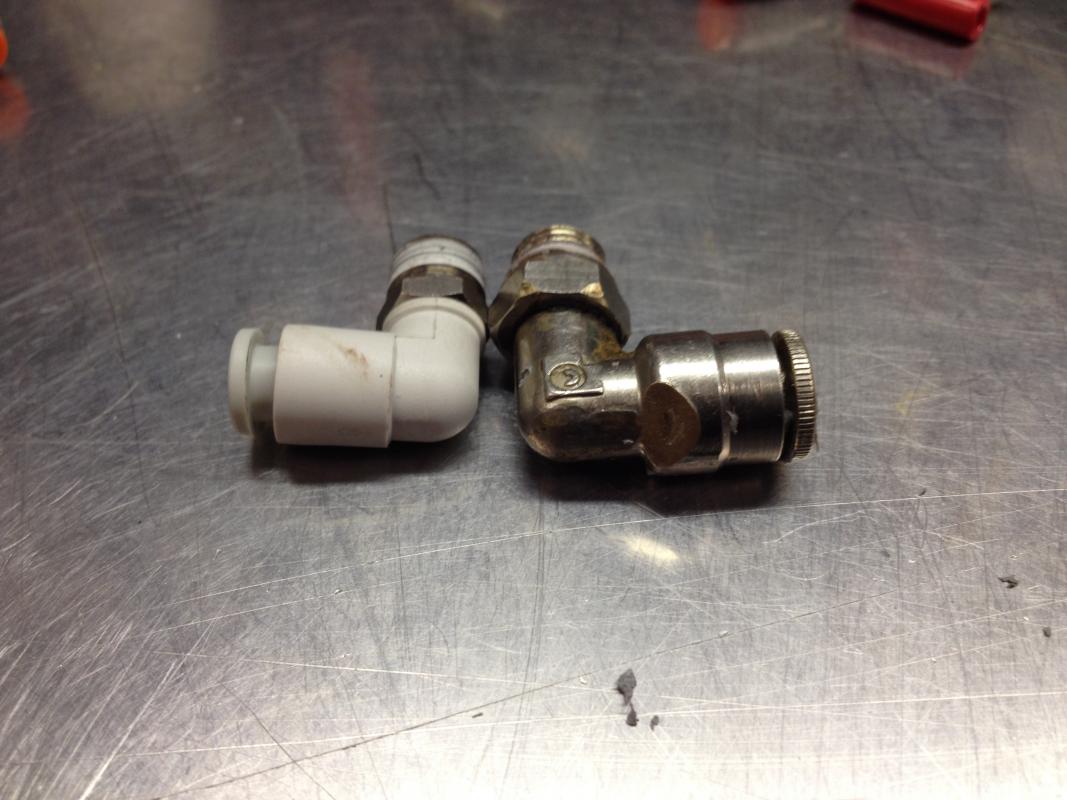

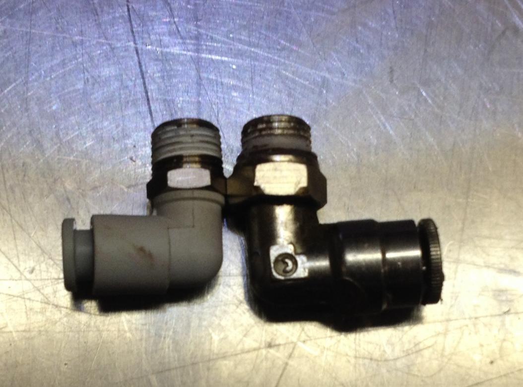

Good old Airbagman have come through with some new fittings. They sent me 6 fittings to try, free of charge and sent via express post. I really must rate their customer service as outstanding. Even the very best products can have problems, its how the company deals with them that makes the difference. The fitting I will use is pictured below. As you can see it much lower profile, approximately 5mm, this should give plenty of clearance. The fitting is for 6mm not 1/4 so the air line is much tighter to fit and may not be able to be easily removed, not really a problem as you just disconnect the airline at the other end and draw it through.
I will try and install them this week and get some pictures.
I installed the lower profile fittings today and they do give much more clearance. I am able to get my finger over the top of them now so there is plenty of clearance and I don't expect any more troubles with them rubbing.

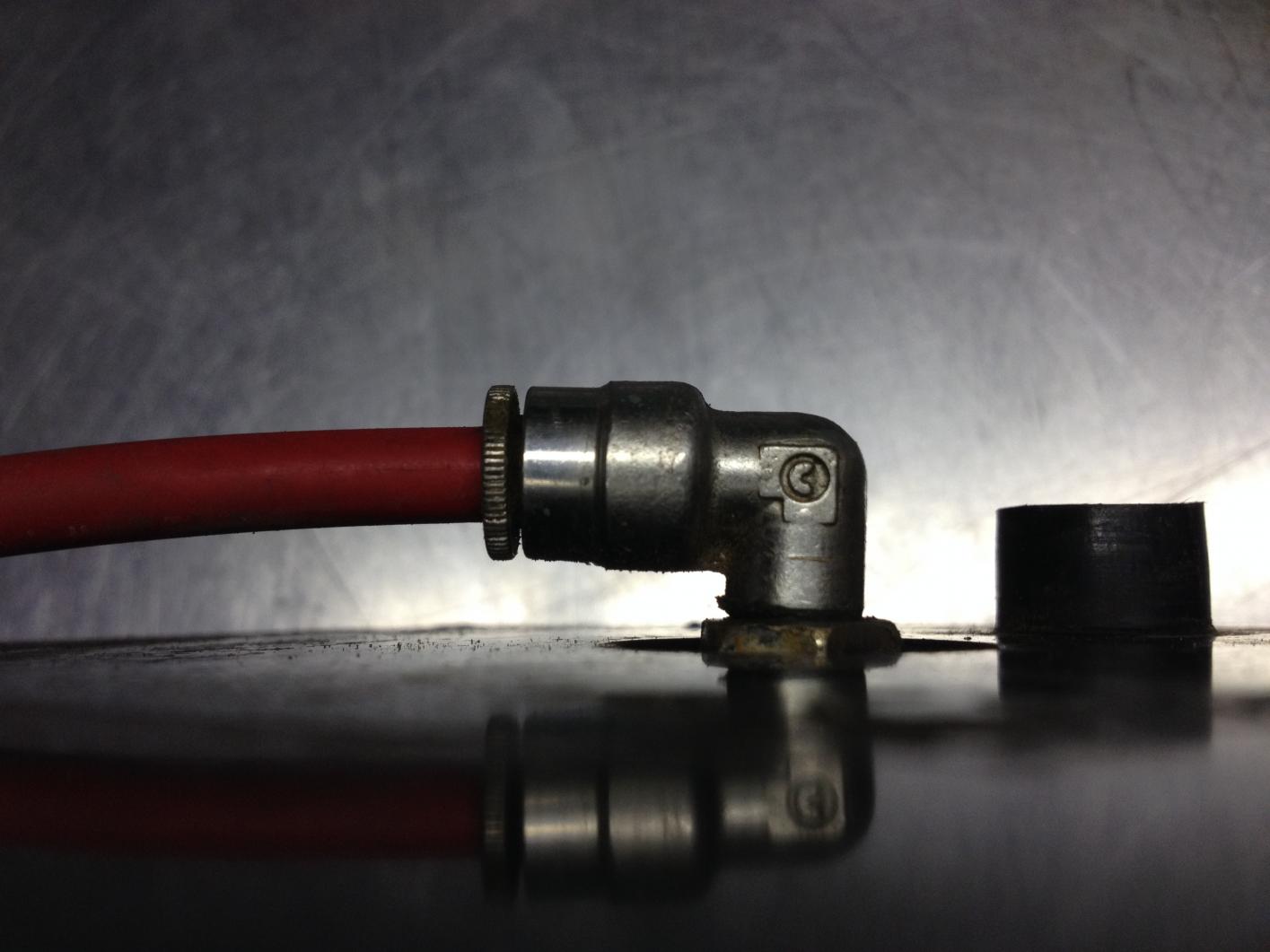

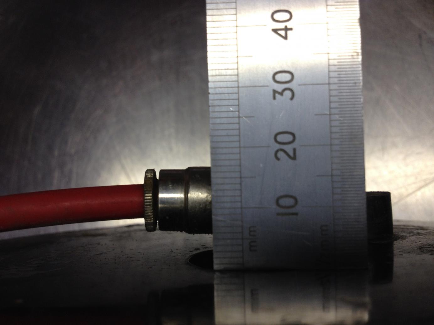

These are the old fittings, they sit 17mm high

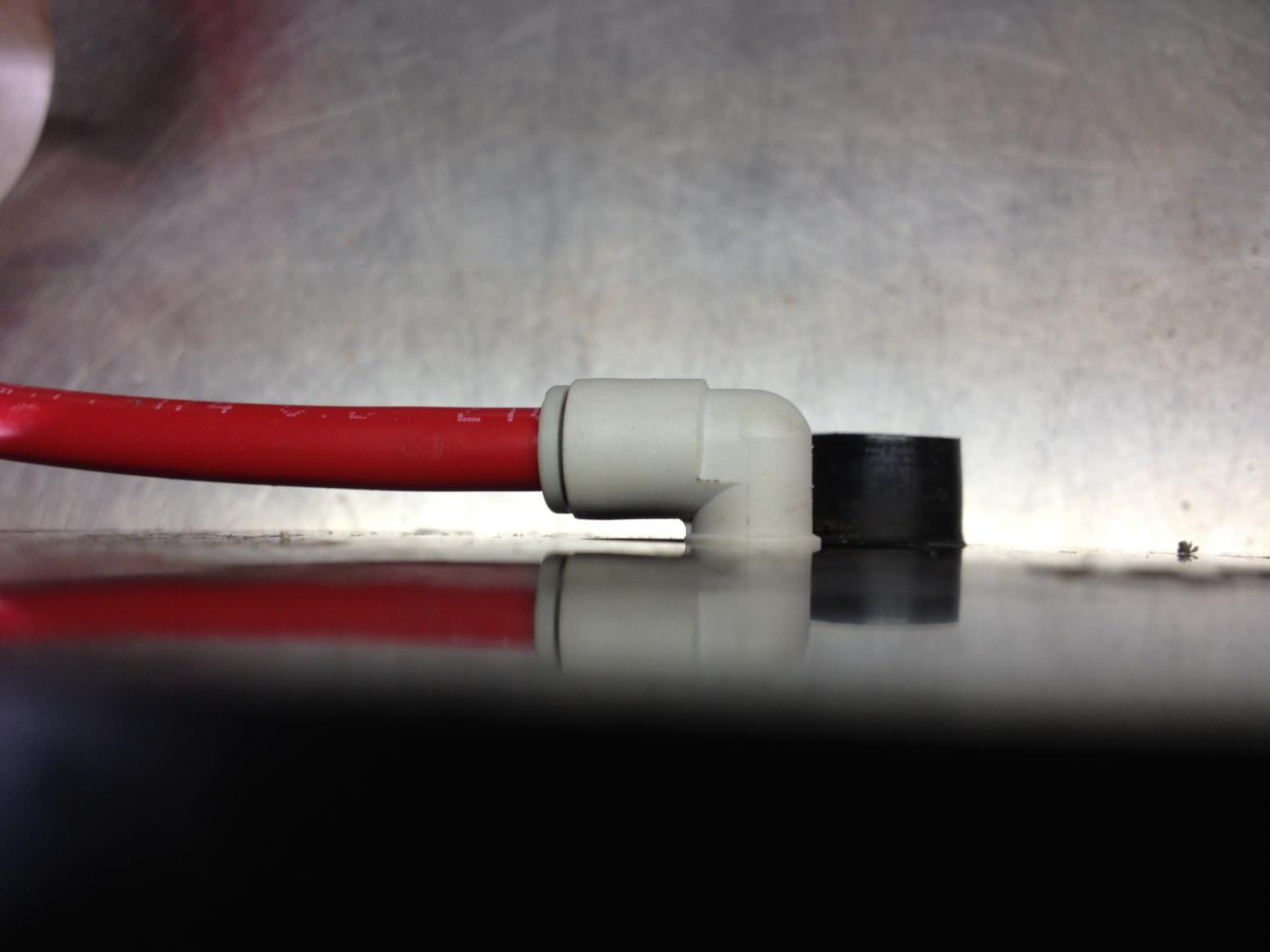

These are the new fittings which are only 12mm high giving an extra 5mm clearance.
The new fittings installed with plenty of clearance now.[FONT=Comic Sans MS][B][COLOR=#000080][COLOR=#FF0000]2003 V6 Parado Grande.[/COLOR][/COLOR]
