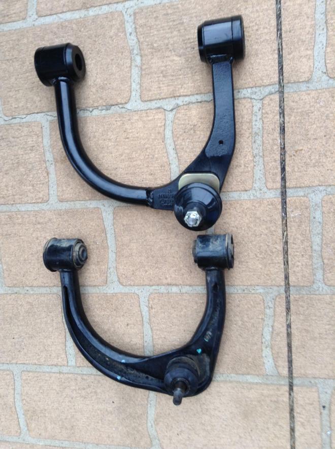

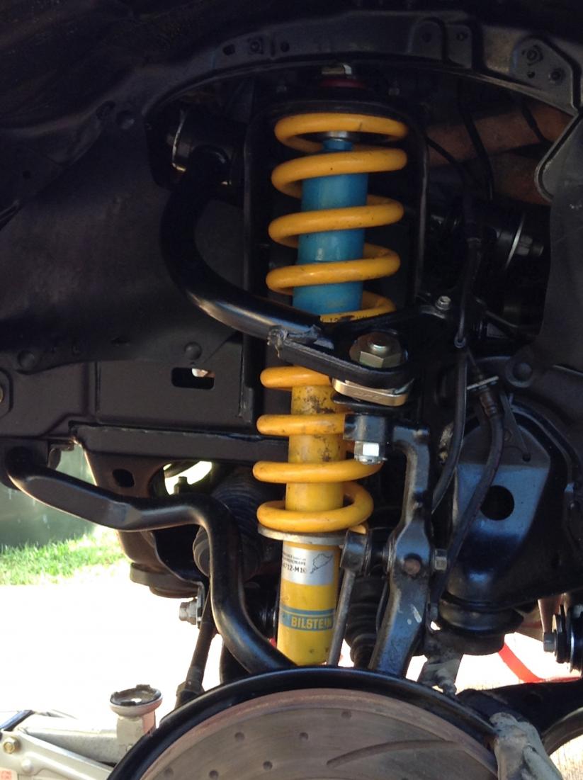

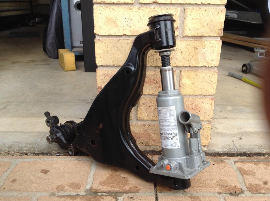

          I have recently replaced the bushes in my lower control arms with Whiteline bushes and found them to give a great ride. Below are some pictures of how I removed my bushes, I did have to use the press to put the new bushes in. I think the kit was around $220. I also changed the upper control arms to SPC arms. Now I have heaps of wheel alignment adjustment and Highly recommend them.
