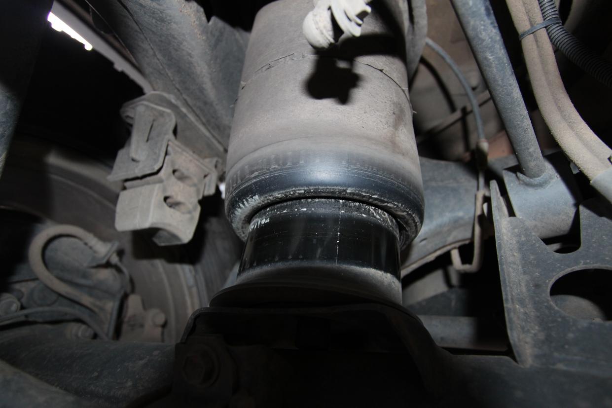

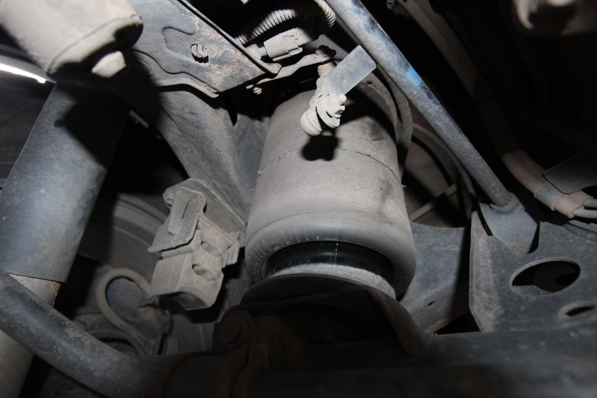

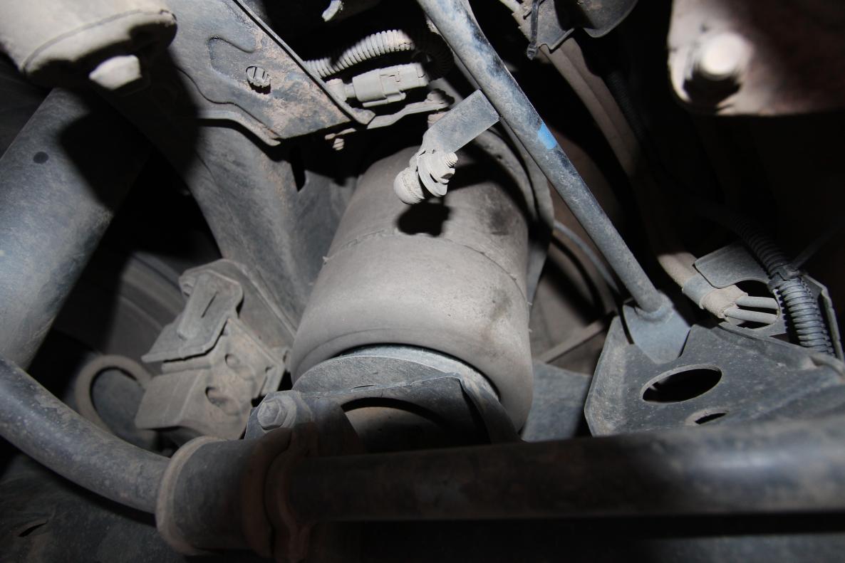

                    If you had a 2" lift, the front should be at 790-800mm. The rear should be at 820-830mm. I don't think the rear is at full compression. Can you post a photo of the airbags?
                      The front has settled down to 770mm
                      Bar and winch
                      I will get under and get a photo of the bags tomorrow for you
                        If anything the lower ride height would mean there is less air pressure in the airbag giving a softer ride. My rear height is around 830-840mm I run Bilstein non-adjustable shocks which I think are too soft. Its possible that because the rear is softer large bumps might be causing it to bottom out on the bump stops?
                          Thats the 3 settings Lo Normal and Hi
                            Sorry 3rd photo did not load
                              They defiantly look a little low but not excessively so. Your high setting is close to my normal setting. If you think it is bottoming out on the bump stops it wouldn't be too hard to test this. Just place some sort of indicator material, e.g. blutac, grease or something similar, on the bump stop that would indicate if it had touched the diff and go for a drive in an area where you were have the previous problems. If its bottoming out its probably not your shocks. Another option is take it to Pedders Suspension and get it put on their suspension test machine, this will give you a printout of the shocks performance. If the shocks are found faulty it gives proof to take back to your supplier.

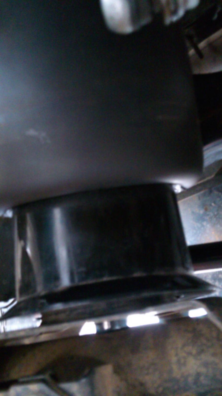

                              A picture of my airbag which was at a ride height of 810mm.
