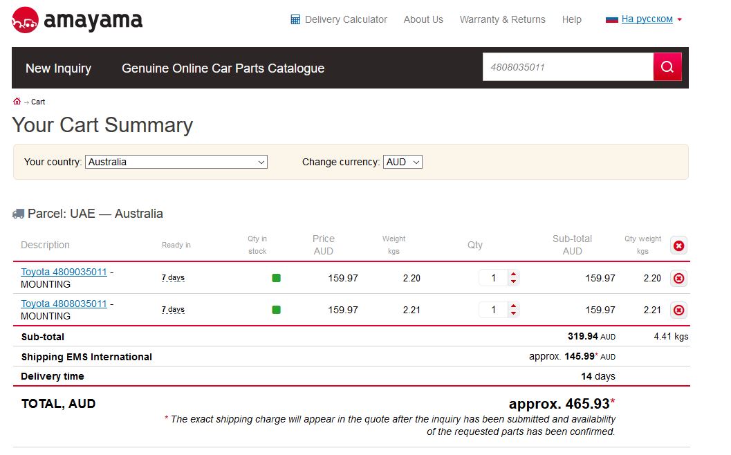

                              Hi All,
                              Just to confirm (so that I don't waste money I can't afford) here is a screen shot of the airbags I am going to buy from amayama - can anyone confirm whether these are the correct parts??
                              Thanks for your help!
