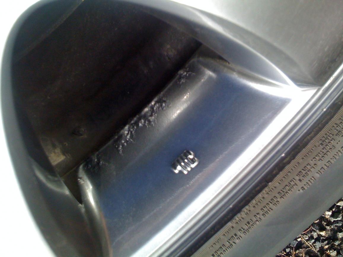

                          120 series Alloy Wheel Corrosion?
                          Hi All,
                          Has anyone experienced the paint bubbling on their alloys. My unused spare which has been under the hard wheel cover for 3.5 years of 4 years of ownership from new is the worst with one of the rims on the car showing it as well. Is it a warrantable item (I have Toyota extended warranty). The photos were taken from my phone so could be better but you should get the idea.

                              Ive seen this on anodized and powder coated parts before.......
                              There is a chance with salty moist air coating these types of products around a join or crease area that it gets in...then over a period of time the aluminium underneath oxodizes....Alloy rust per say....or it can be that that part of the wheel was not prepped right at the coating phase...ultimatly...same result with two causes
