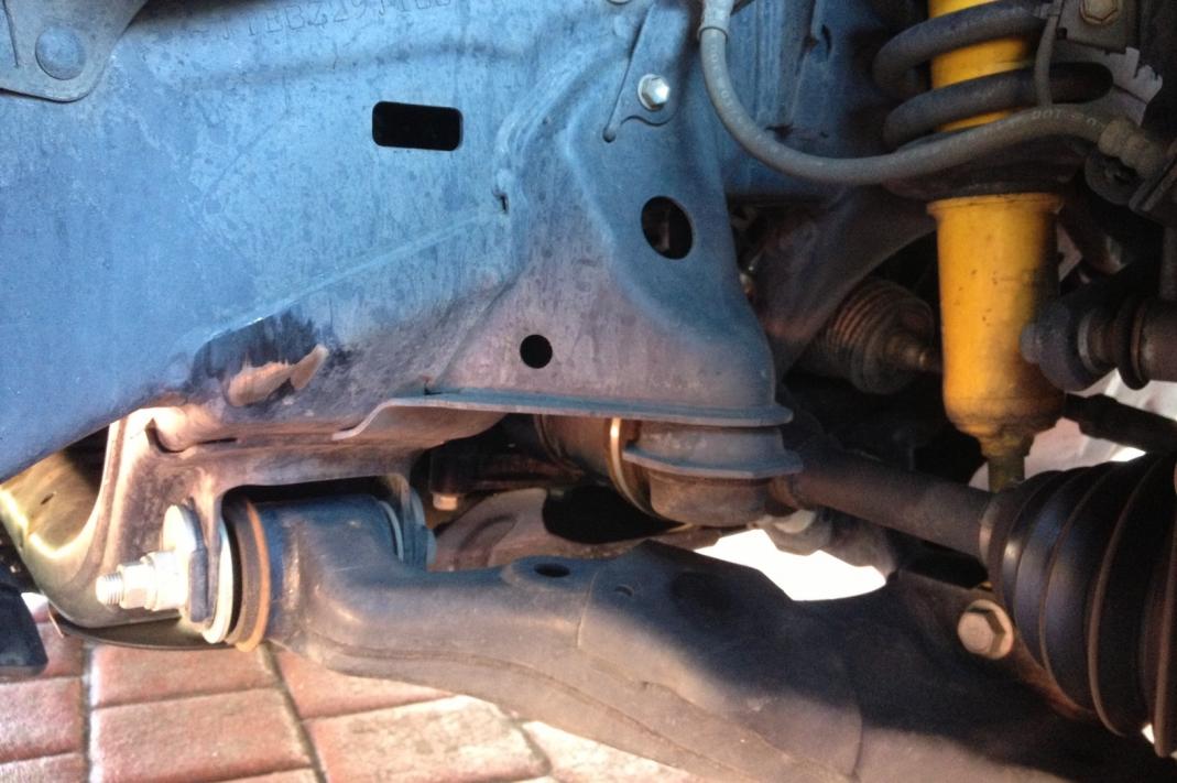

I agree, even with my 2" Lift and Mickey Thompson ATZ's in 265/70 I have some rubbing - allbeit it on the chassis railOriginally posted by AJ120 View PostLift or no lift 265/70/17 is the biggest you can fit without making other alterations. First problem with going to a 285 is they will rub on the upper control arms (UCA). so you either need to change the UCA to an aftermarket version giving more clearance or change the offset of your rims or both.
Micheal.
Strange. I don't get any with my 265/70R17 Wrangler MTRs. Which ATZ have you got? The P3? Perhaps it is the squarer shoulders compared to mine which is more rounded.Originally posted by 120D4D View PostI agree, even with my 2" Lift and Mickey Thompson ATZ's in 265/70 I have some rubbing - allbeit it on the chassis rail
[ATTACH=CONFIG]17057[/ATTACH]
I have the 5 Rib ATZ's.
Many moons ago (when I still had some tread on them) they appear to have rubbed under compression on full lock. Nowadays there is a gap...
But yes the tread block pattern was quite square.Cheers
Micheal.
I get exactly the same with my BFG AT's, I never feel it but the shiny patch on the chassis is a giveaway.
