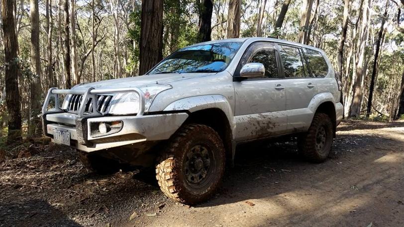

            I'm running 33" x 10.5" x 17" / 285 x 70 x 17 muddies.
            I have a +3" lift and 2015 fj cruiser rims which have an et15 offset.
            Do they fit? Yes
            Do they stick out past the flares? No
            Do I touch anything full lock / full travel? Yes. At absolutely full lock I just rub the chassis with the rear inside of the tyre. When I am tucking a wheel or going over large bumps the wheel touches the inside of the guards which make's some noise. I was also rubbing my front mudguards but a heat gun remoulding them against the chassis fixed that.
            Am I happy with the trade offs? Hell yeah! Loads of clearance, great traction, looks awesome.
