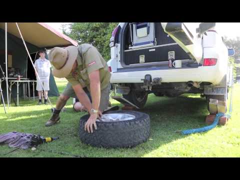

                  Hi guys, here is my version of a bead breaker that i made a few years ago. i have never had to use it other than the test run after i made it (never had a flatty) but it works ok, although it is a bit slow as you need to keep going up and down and spinning the tyre a few times until the bead breaks.
                  this bolts to the OE jack
                  then place the tyre under the tow hitch (or anything else convenient) and wind the jack up.
                              Looking for something else I stumbled upon this old thread, I have now used the bead breaker plenty of times in the bush, works a treat
                              Some video of me using it at the 2012 GTG (thanks to Snaga)
