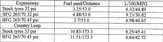

Expressway test. Car fully warmed up before refuel at service centre on the M4. A/C off. Drive at 100 kph west on the M4 (110 was too difficult to maintain consistently), take an offramp and drive back east, offramp and return west to the same garage. Total distance on the fixed route 53.0
Standard tyres at 32 psi (placard figure + 10 %- a realistic everyday use figure):
Fixed route distance by Google 53.0 klm. Odo read 51.8. Actual fuel consumption 6.32/100, 44.89 mpg
BFG KO2's 265/70R17 also at 32 psi:
Odo read 50.0. Actual fuel consumption 9.21/100, 30.82 mpg (!)
This figure was so bad, I had to try it again. Some increase in fuel use is expected even with same size tyres due the more aggressive tread pattern, but not this much. This time I upped the pressure to an unrealistic (I thought) 45 psi.
Odo read 49.9. Actual fuel consumption 6.98/100, 40.65 mpg.
Country Drive Test: This next test involved a 173.3 klm loop on very quiet, narrow, undulating extra urban roads where the speed limit varied a lot between 60, 80, 90 and 100 kph. About 33 klm of it was also expressway.
The fuel use was so bad with the BFG's at 32 psi that I stuck with the 45 psi. Once again, the car was fully warmed up prior to the refuel.
Standard tyres at 32 psi:
Fixed route distance by Google 173.3 klm. Actual fuel consumption 6.25/100, 45.41 mpg
BFG KO2's 265/70R17 at 45 psi:
Odo read 165.6. Actual fuel consumption 6.64/100, 42.72 mpg
