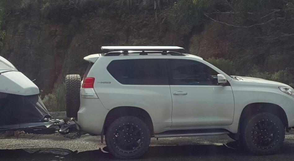

    No problem with the size you want, it does go close to the sunroof but only when opened at the back.
    Excuse the poor photo quality, it has been considerably cropped.

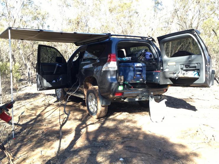

                  I have the rhino rack bars.Click image for larger version
                  Perfect for my roof top tent, with shovel holder. I also have the awning attached nowClick image for larger version
                    Nice setup. Looks great
