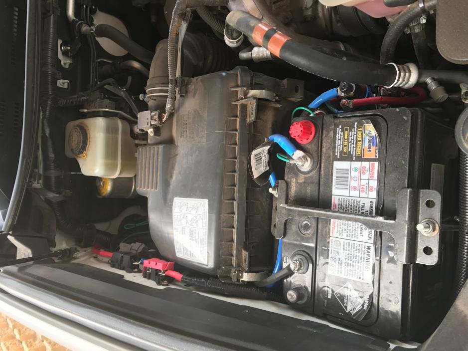

    Hi, bit late response this as i haven't logged on for a while. I have a allrounder MRV50 installed on a ARB tray , did it myself with the SBI12. The MRV70 was a few cm's too big. Picture of my buggy attached, let me know if you have any questions.
