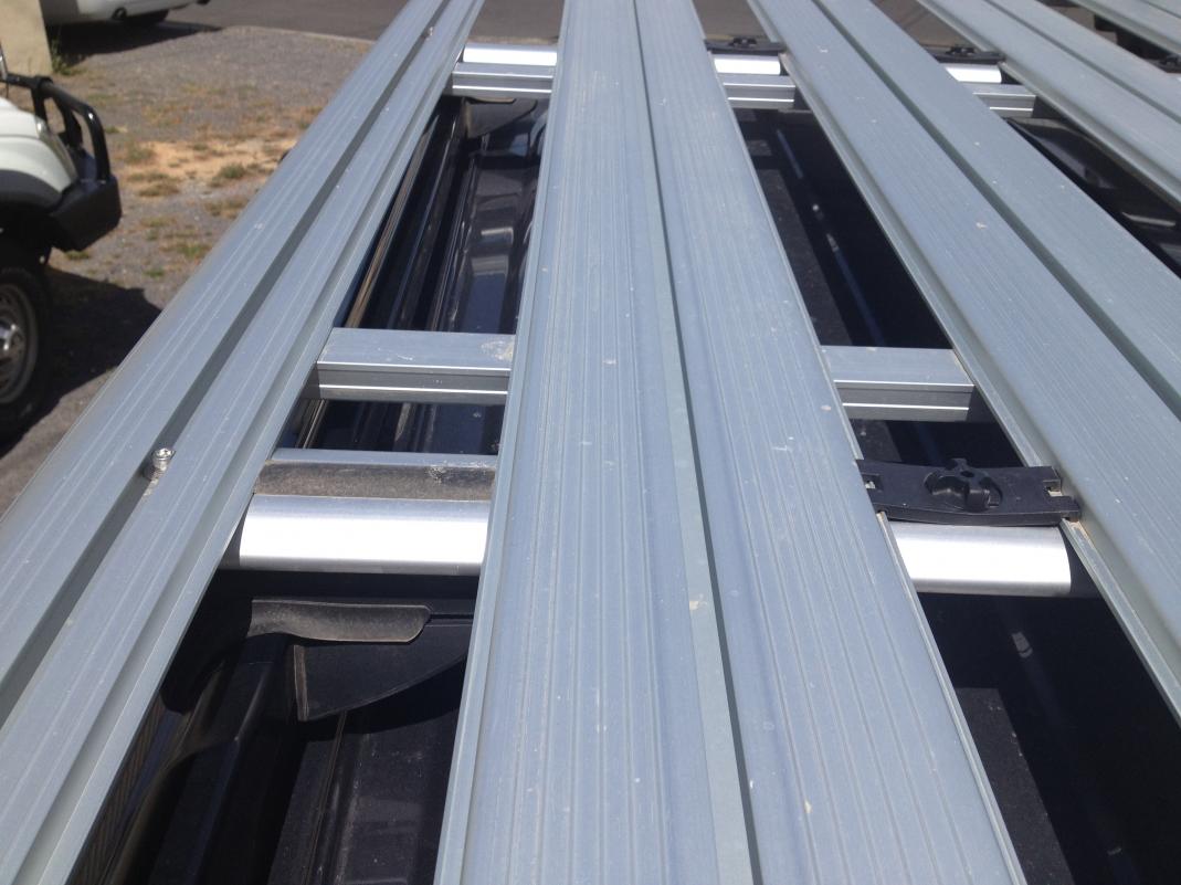

                            • Bendman, the black looks great, will look even better on the Graphite. I wish it was available when I bought mine, I presume it's anodised and hopefully won't scratch. Hopefully they've sorted out their rear cross brace. When my platform arrived the brace was in the wrong spot and interfered with the position of the roof bar. After talking to Rhino, they had just discovered the problem as well, so I drilled out the pop rivets and moved it to the correct spot. They were really apologetic and compensated me for the mix up. I did offer to accept a Foxwing to offset the fix, they weren't quite that keen unfortunately!

                              • Bendman, he did offer me the brackets from the platform to the foxwing, close but not quite. Here is a shot looking down on the platform from the back. If your whispbars are no longer than 1150 mm long you may be able to get away with it. When I got mine the platform and cross bars that attach to the rails were seperate. The instructions give you measurements of where to mount them to the factory rails, once the sxb legs and cross bars are fitted the platform sits over the top. It then bolts down into the cross rails, there are also plastic clips which look into the cross rails between each plank of the platform. You can see this in the photo.
