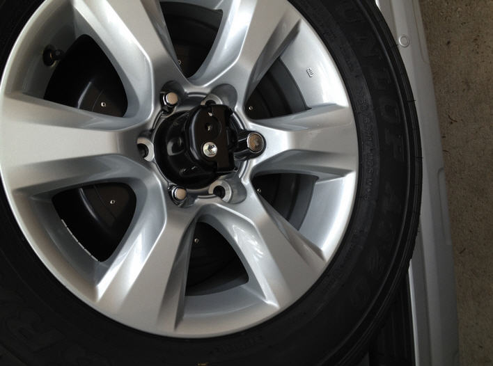

    I am looking at a Bike carrier for 2 Bikes which can be mounted on the 2011 Prado 150 Spare Wheel - there are a few products around but none seem to have strength and versatility to get around the rear camera in the Spare Wheel Hub...has anyone done this ?

                  This was partly why I got the GX Prado (rather than GXL) so it saved relocating the rear view camera mounted on the spare wheel
