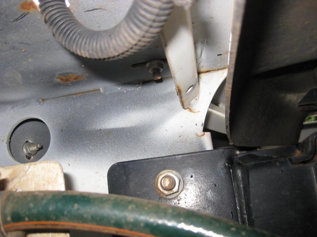

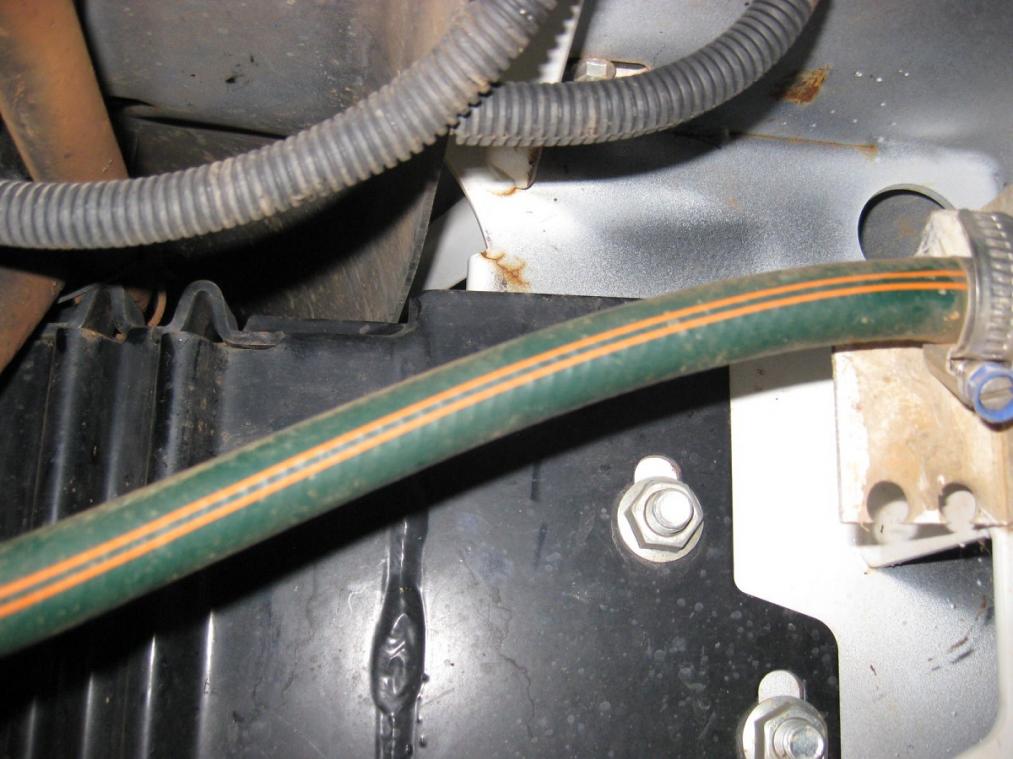

    Just checking behind the bull bar today and noticed cracks in the mounting plates on the bull bar where it attaches to the crumple mounting brackets. Both sides have cracks.

        Are they cracks in the steel or just the powder coat?
          Without seeing it first hand they don't look like cracks. The top one is a bit of cold roll which hasn't had paint coverage and the second looks like it is just bad painting. Can you take some closer shots of each crack? Any sign of the same on the other side? Happy to have a close look if you like.
            The top one is not a crack, it is just rust stain running out from under a weld.
            The bottom one is a crack, powder coating under the bar is very poor as you can see by the rust.
            The other side has a crack as well but not as bad.
            The crack is in the bullbar mount.
            The bar was fitted in March 2010, nearly 2 years ago, the vehicle has travelled @50,000k with the bull bar fitted.

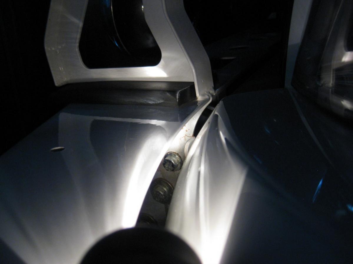

                  I found the crack from underneath when I had the sump guard off. But it can be seen from on top. Its easier to look for the crack in a dark place and use a torch to light up the area. Look at the mounting plate from the top side of the bullbar, on white the rusty crack stands out, not sure how other colours will fair.
