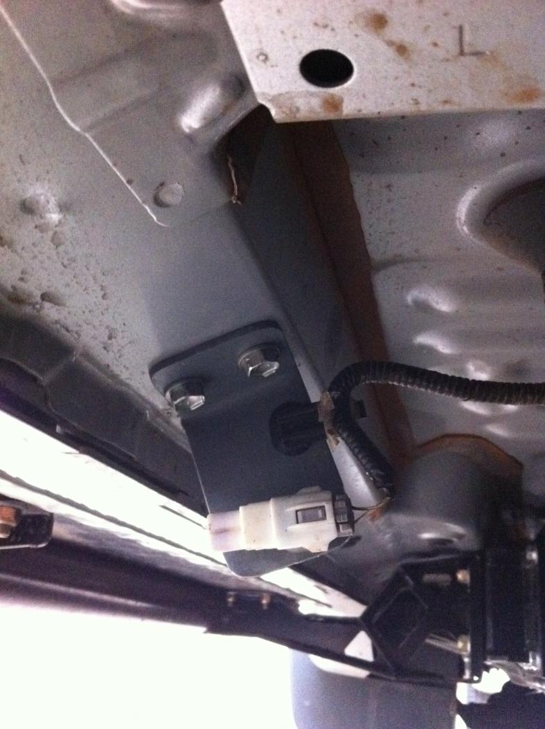

    ive been a member for a while and this is my first post so ill introduce myself my name is Darren, and im from Adelaide SA. Ive recently bought a new 2012 150 series prado GXL in turbo diesel manual, ive had it for a month and couldnt be happier with it, my last car was a triton so theres a big difference between the two. My question is regarding the TJM steel side steps i fitted a set on the weekend, i was told they were side air bag compatible there is a sensor on the left hand side that i gather is the side air bag sensor. i had to make up a bracket for it to go on as there was nothing with the kit. If others have fitted themselves or had TJM fit them what was used for mounting the sensor back to the car. Thanks for your time.

          Hi, thanks for the replies , ive attached a picture if its not the airbag sensor what do you guys think it is.
          Darren
                Darren
                Hi Darren, do you have one on the right hand side as well? The only thing I can think of it's the wiring harness for the sidestep illumination on the VX and Kakadu. These have two (2) lights on each side which are actually mounted to the underside of the side steps.
                That's all I can think of.

                  no its only on one side , and it was mounted to the original steps. thanks for the thoughts. If the other guys had theres done by tjm was there anything like this left over or was it taken off.
                  Darren
                  ruger.308

                    That is just a plug with a water proof plug blank on it to protect the circuit. I think you will find it is for the VX / Kakadu step illumination and there will be one on the opposite side just mounted in a different area. If you remove the blank off of that duetsch plug (the grey plug) you will see it is just a blank cap. The airbag sensors look entirely different and are a solid looking black angled rectangle box thing.
                    I would remove your bracket and tuck the cable up and zip tie it out of the way so that it does not get hung up next time you head out and play.
                    Hope this helps.
                    Daniel
                      Thanks heaps for that. I was hoping it would be something simple like that.

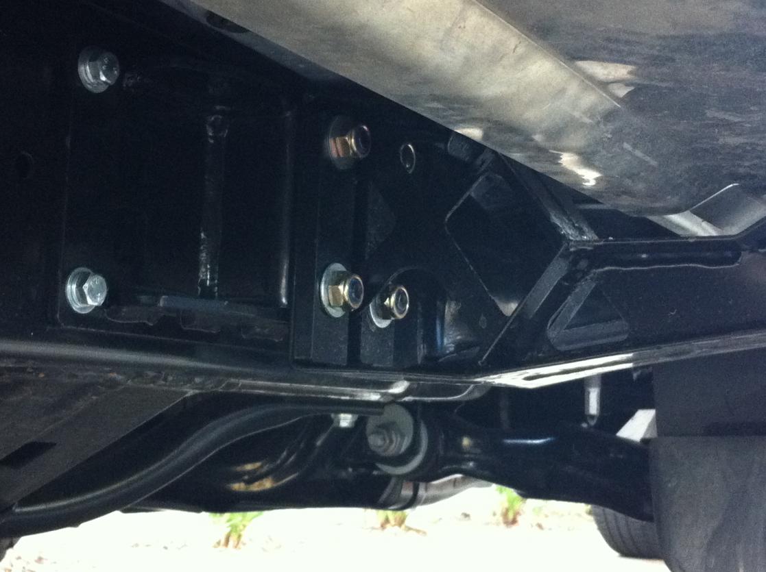

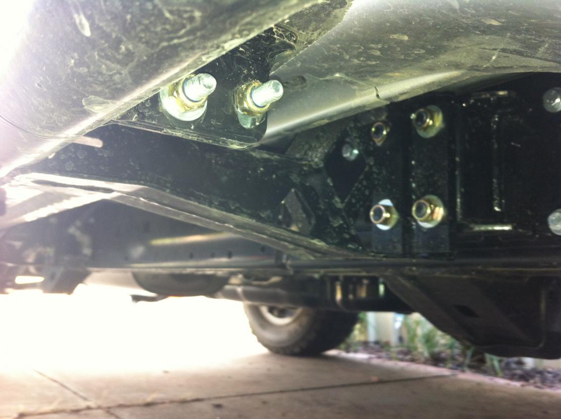

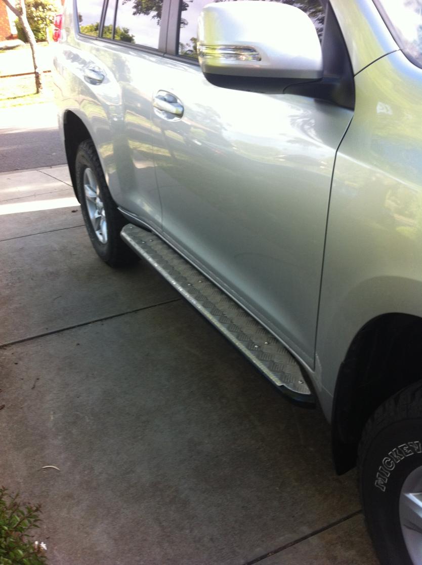

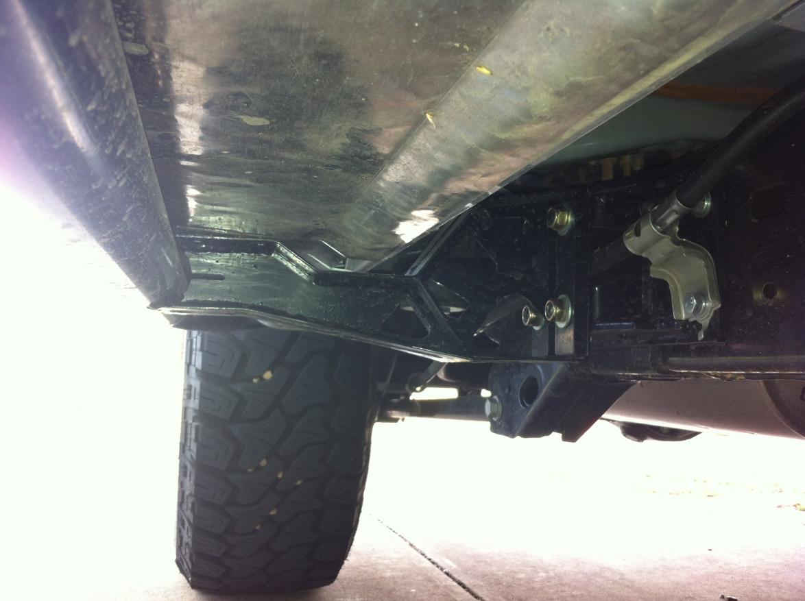

                            here you go the pics as promised, there not the best but gives an idea of them.
                            Darren
                              they look pretty good.
