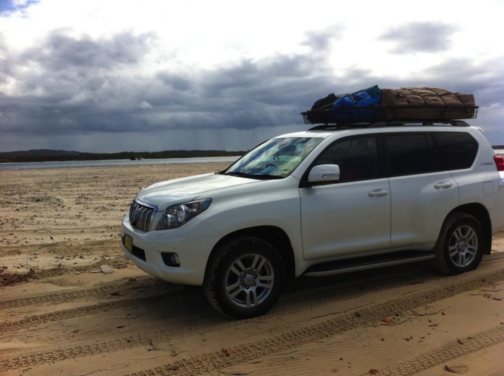

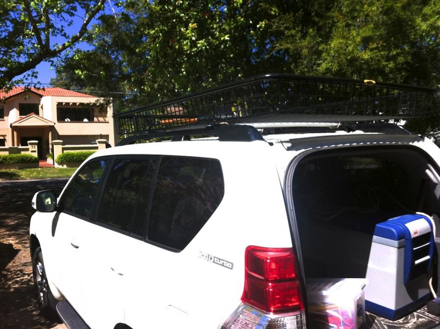

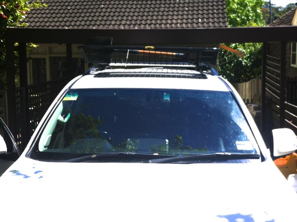

                        I have fitted Whispbars to my factory rails and a rhino mesh tray (roughly 1100x1800). Saves $$ and height. I like the combo as the whispbars are almost invisible. I also like the Rhino Platform. Click image for larger version

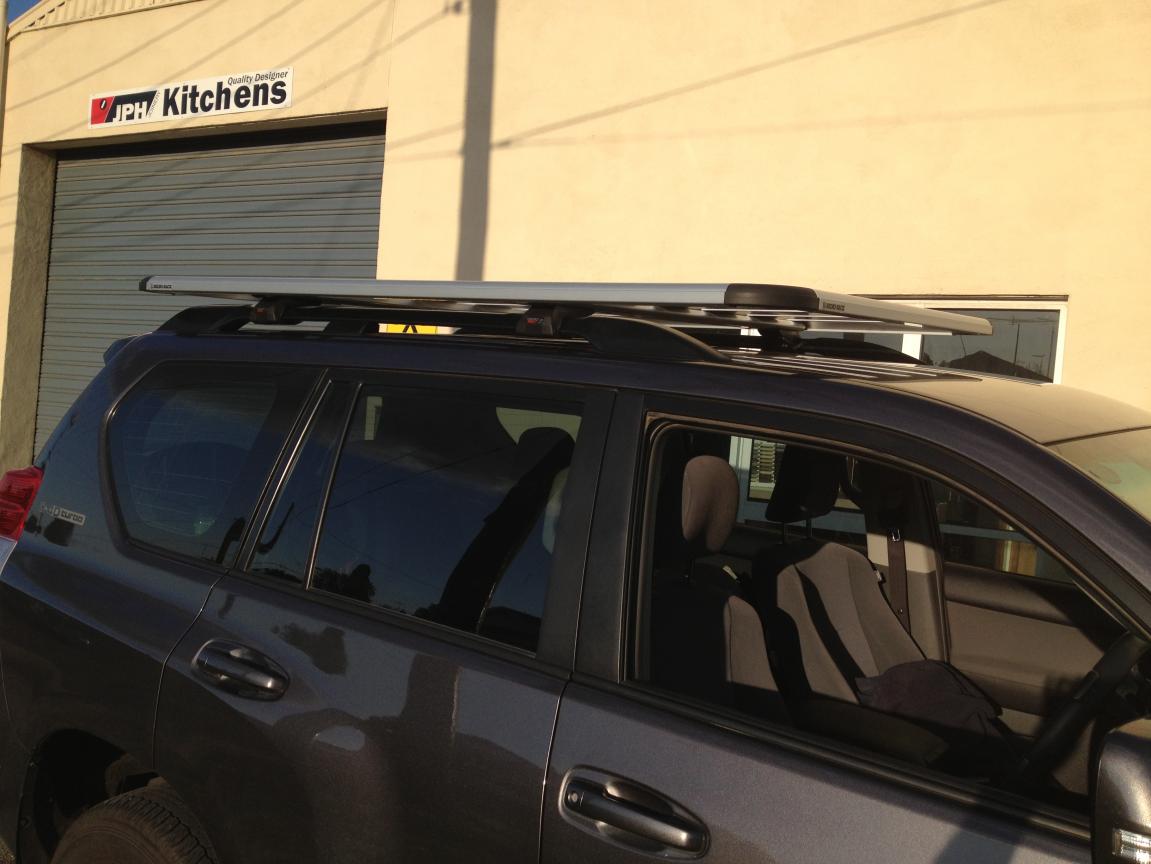

                          I have just fitted a Rhino Pioneer Platform to the factory rails. It's a 42102SXB, so a good size but nice low profile, but also means I can add side or front rails to it at any stage. Managed to do a great deal at the Melbourne 4x4 show! Apparently it's a new set up where the bracket attached to two bars is clamped onto the rails. The platform then fixes to the cross bars.
                            JPH
                            Just worked out (hopefully) how to upload a photo of the Pioneer Rack.
                            150 with stuff bolted on!
                              [ATTACH=CONFIG]7810[/ATTACH]
                              Looks awesome. Did not know that it's possible with the factory rails. What are the brackets you got with the platform? Can I ask how much you paid?
