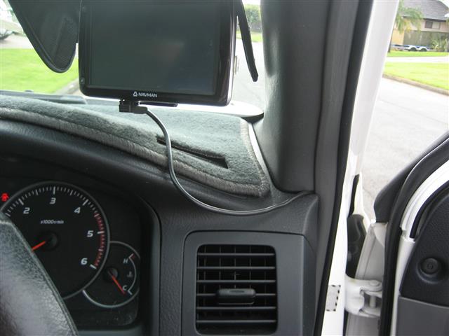

                This is a photo of mine, probably similar to Hutch
                Pedro
