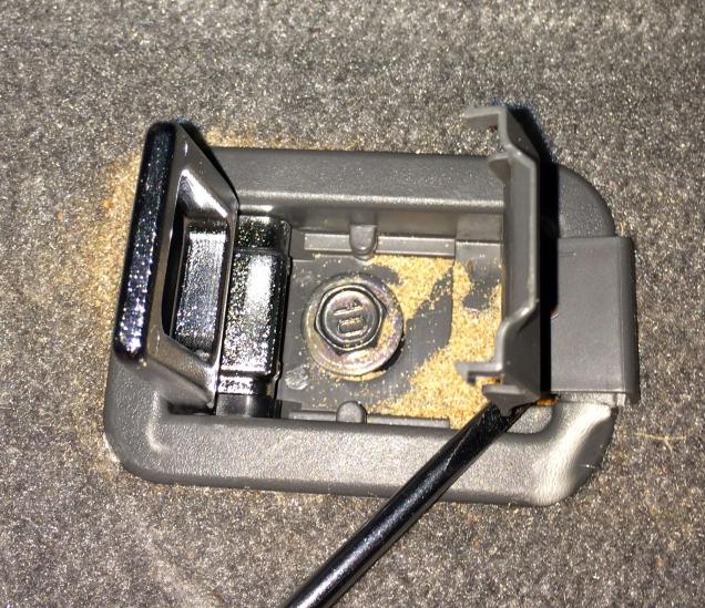

    Step 1 - Remove the rear tie down anchors (one on each side, use a flat-head screwdriver to lift the cover flap & remove the 10mm bolts, the anchors are now loose)

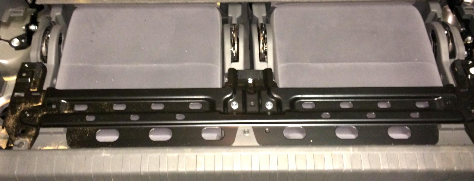

    Step 3 - Remove the six 10mm bolts (silver) that hold down the cover frame (two left side to base, two right side to base and two top [shown in photo])

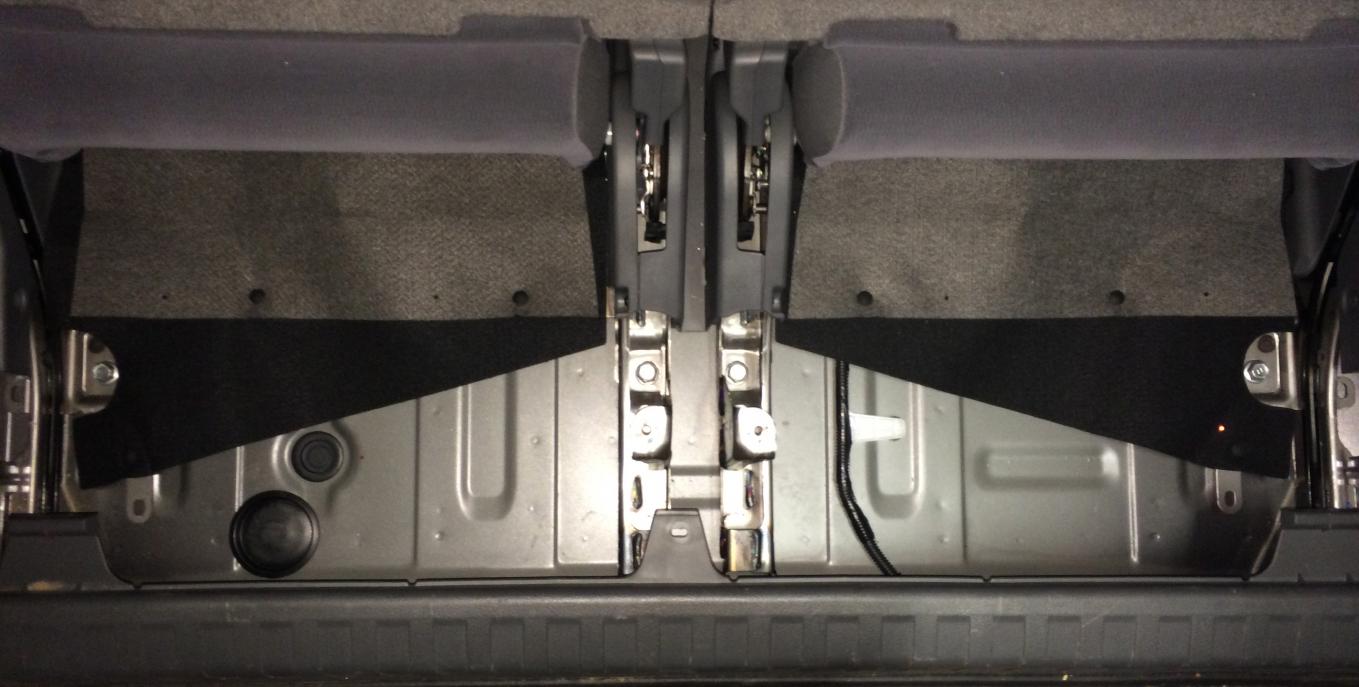

    Step 6 - Remove the four 14mm bolts that hold the seats down at the rear (two per seat). These were in pretty tight! Four silver bolts in photo

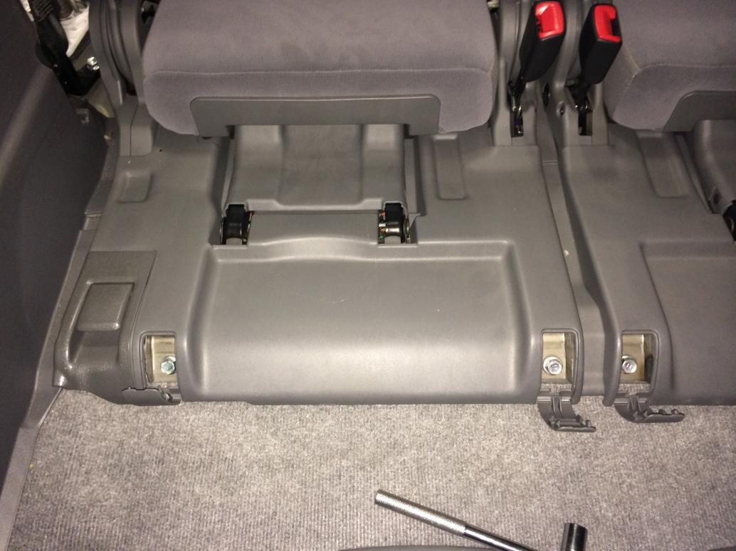

    Step 7 - Remove the four 14mm bolts that hold the seats down at the front (two per seat again, use a flat-head screwdriver to lift the cover)
