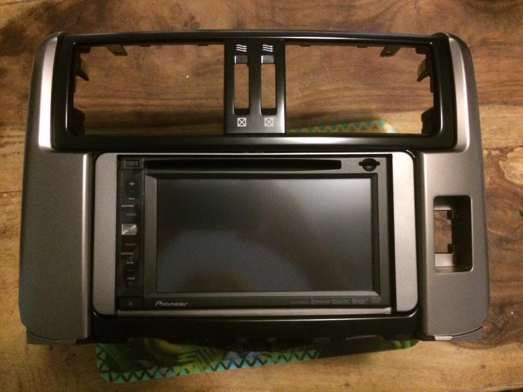

                      I ended up getting the toyota gx AC surround but I will reuse my side panels similar to what you said, mainly because I also have the reverse led display as well as the hazard switch,
                      I also wanted to get the bottom bucket for storage , got through eBay for 300 for dash trim and storage , all genuine toyota,
                      I ended up buying a pioneer Avic f950 with DAB radio, as JB hifi where having a 30% off car audio deal on Australia Day, so got it for around 1k and it had everything I wanted including App Radio where I can can control my iphone 5 apps through this unit. Browser , nav etc.
                      The only thing it doesn't have is off road maps however I think I will stick to using my ipad mini for this as I have the memory maps and converted all my hema ozi maps to work on this so have this covered,
                      Now just need to get it installed, trying to find a good car electrician to install and get everything else working , steering wheel controls, reverse camera , inputs etc. if anyone can recommend anyone in the ACT that would be much appreciated, Click image for larger version
