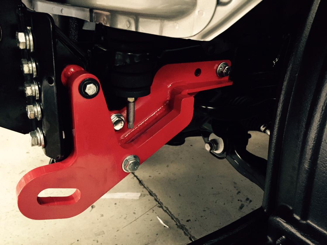

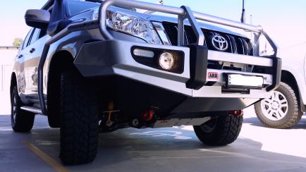

          I had them fitted on my new build:
            I had a pair of ARB recovery points (red in colour) installed on my 2014 150 GXL. It requires the removal of the bull bar which wasnt a problem because I was also having a winch installed at the same time. Expensive at over $600 installed, but industrial and look good too. ARB kow how to charge, but really good gear.
