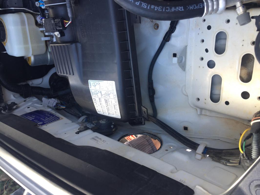

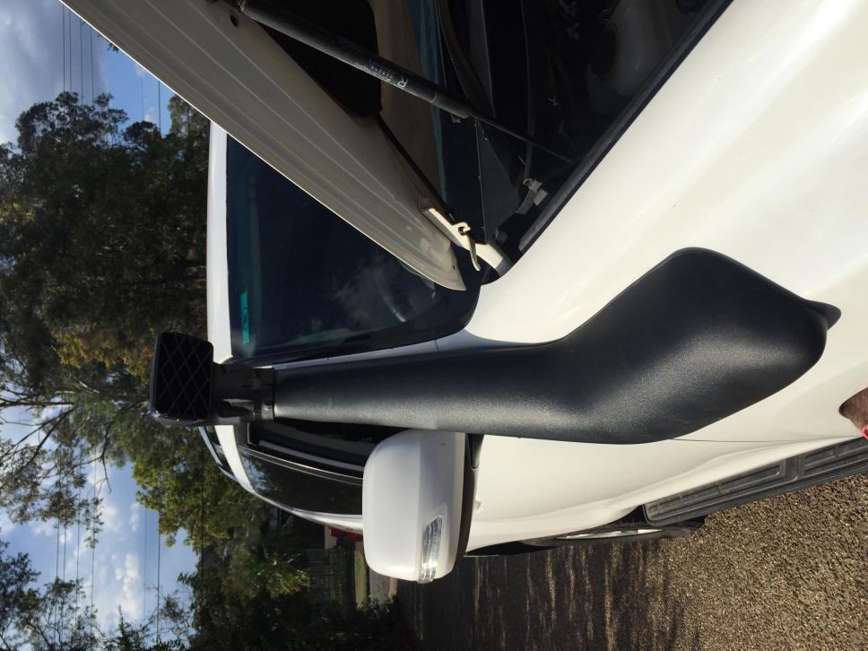

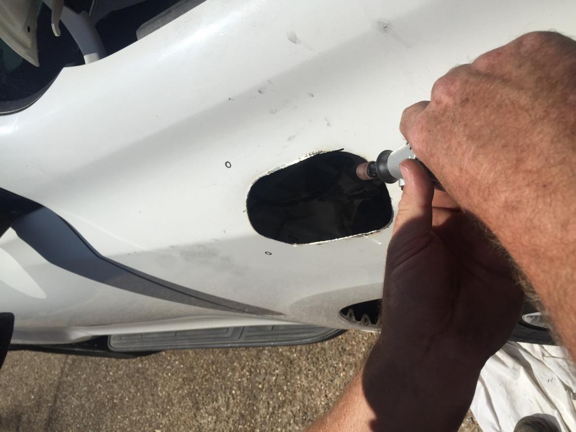

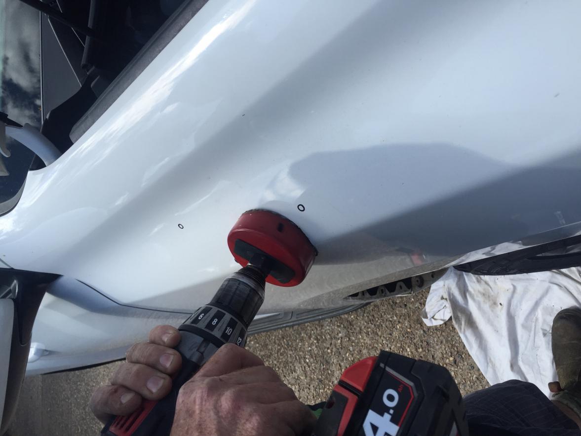

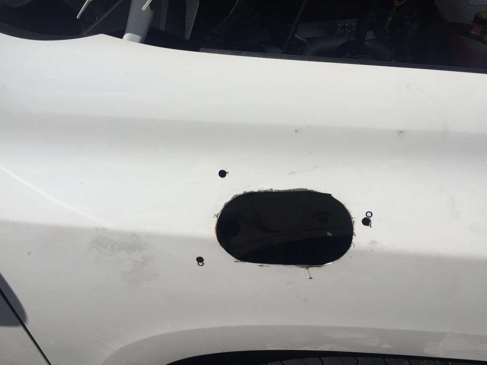

                ok i just got a $92 tuff terrain on off ebay install was good but when i put the car under load it sucks the inner guard pipe together and kills all revs makes a very loud sucking sound, i have emailed them tonight to see if this is a common fault has any one had this prob or fitted one like it and had no probs ??? i got some pics here ... do you sika the drain hole in the air box ??

                    Hard to see from the sellers add but is that inner pipe plastic or rubber ? Looks similar to one I got but the inner rubber pipe was very solid rubber no chance of it ever sucking in. And yes I sealed the drain hole but left the flapper drain as is.

                      Yes mine is rubber, still no response from the seller as of yet !!!
