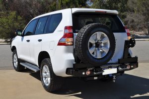

    I am looking at getting a rear wheel carrier for rear protection and to carry two spares for long remote trips. I am pretty set on an MCC carrier (Click image for larger version
ID:	662004) due to the much lower price than kaymar etc. I know it has fewer mounting points than the more expensive carriers which doesn't concern me much but I just read about a few bad experiences with them and I am starting to worry.
    Does anyone have some advice on choosing a rear wheel carrier?

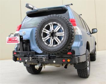

      We have a MCC dual wheel carrier on our 120.
      It has been bounced over the outback for several years, and no failures. No rubbing that I can see.
      There are some rubber crimp covers for the gap between the bar and the guard, they do occasionally loosen but have not been lost (yet)

          The MCC bar is designed to fit the Toyota bar and some other bars. Pretty sure Hayman Reese is one of them.
          Here is the MCC 120 bar with the Toyota towbar:
          You can see the plate above the towbar which is removable to fit alternative bars.
          Sorry about the dirt. lol.
