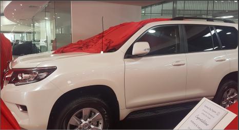

    My new gxl is sitting in the showroom waiting for me 🙂
