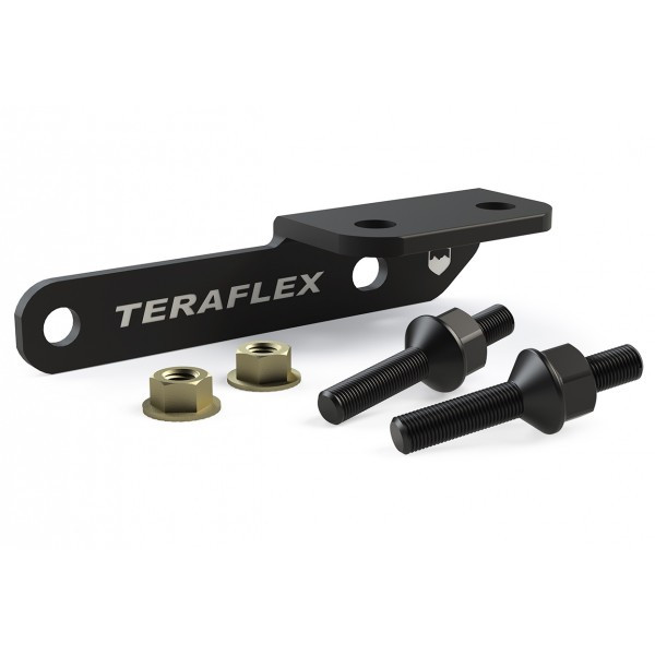

          Hi Gunda, I purchased a Teraflex 4997192 JL: CB Antenna & Flag Whip Mount Bracket Kit from Amazon Au some months ago but it now appears to be out of stock. However I also found it advertised on this site…
          https://www.sbroffroad.com.au/TeraFl...-Antenna-Mount
          I fitted it to my roof rack using a couple of L shape brackets from Bunnings.
          It could possibly be fitted in similar fashion to a roof bar such as the Rhino-Rack Vortex Bar 1260 (VA126B) instead of a roof rack or perhaps adapted to bolt onto the tailgate - although it’s specifically designed to fit a Jeep Wrangler tailgate using the mounting studs.
          Click image for larger version  Name:	image_26439.jpg Views:	0 Size:	34.1 KB ID:	758986

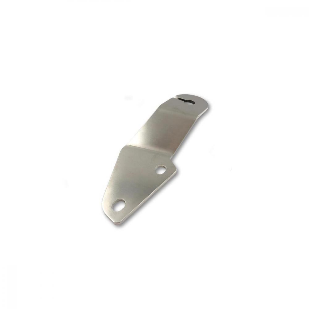

              Does anyone know anything about / have any experience with this flat Kaon bonnet antenna mount?:
              https://www.kaon.com.au/bonnet-hinge...-for-prado-150
              The bonnet brackets that I was worried about and was warned about were the right-angled ones. These flat ones may be less risky, if they're thick enough and the metal is of sufficient quality.

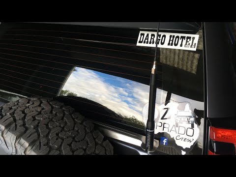

                Hi gunda, this YouTube video might be helpful…
                https://youtu.be/IZQyexUtknY
                MOST RELIABLE & OPERATIONAL ANTENNA BRACKET FOR A TOYOTA Prado LC150
                  Thanks Tow2go, I'd like to think that I'd have found that eventually. One of the comments claimed that it is a copy of the similar (and more expensive) GMF4x4 bracket. It wasn't one of his better videos, as he didn't actually fit an antenna, let alone use it in practice - he just blathered. It looks solid, but I'd be nice to hear of someone who had used either one over corrugations.
                    yes, perhaps the video did need a little more objectivity and a tad less ‘add’ nauseam to be worthy of a thumbs up
