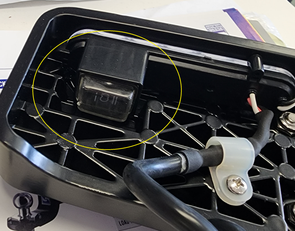

        I actually got in touch with Hayman Reese via email after posting this message last week, and explained to them the exact same thing. One of their Support Staff got back in touch with me and advised that he believed that he knew what the issue was...
        Apparently, so I have just learnt, Hayman Reese has installed a Rocker Switch on the underside of the Hitch Step. The advertising flyer says:
        • Plug-in ready; comes pre-wired with a 7-pin flat plug to suit most applications
        • Multi-function switch configured to illuminate with vehicle reverse lights or park lights (where vehicle has been pre-wired for reverse)
        but I just assumed that they were talking about the 7-pin flat plug, so I didnt even think to look for a Rocker Switch, silly me! - It blended in well thats for sure..... (Images attached)
        Sure enough, once flicked in the opposite direction, it fixed the issue and stopped the LED Lights on the Hitch Step from staying on while in Drive Mode. Now, it works as it should, and comes on when reversing only.
