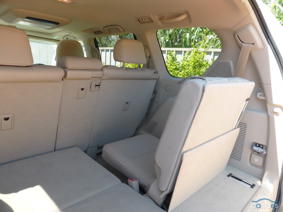

              So going off a pic of a 2010 GXL what are the fixing points in the middle of the seat backs on the 3rd row for then? My kaka is different, it has the rails on the outer edge of the seats for fixing luggage restraints to. It does not have the central fixing point like the GXL so forgive my confusion here.
                Fido there are no fixing point on the 3rd row seat. What you have seen will be the handles to unlock and lift up the seat.
                EmzrRig I don't like your chances, under the floor behind the 3rd row seats is just thin steel sheet. I think the roof would be out because it would be pulling the child seat up rathe than into the seat.
                As yiu can see in the photo the bottom part of the 3rd row seats slides right back to near the door and above that is a this pressed steel panel that goes over the top.

                    OK, so the bit circled in red in my pic below is just a release handle?
                    I always thought the release was just the one on the shoulder of the seat back.
                      It is a release and a handle to pull the seat up, you can use the shoulder ones for that but even with the 2nd row sears folded they are quite awkward to try and lift the 3rd row.

                        OK, that makes sense. The Kakadu doesn't have the manual handles, just the cargo rails same as the VX :-
                          SO Great news!! yes I can get anchors installed into my GLX Prado 2013 150 Series!! as you can see the back of the seat, (where the flap meets the back of the seat) the anchor will go down in there, and i can just use an extender strap to reach the anchor bolted to the car, hope that makes sense. SO for any future owners of this model, dont stress, it can be done :-)Click image for larger version

ID:	647764 PS the picture I think is of a Kakadu, not my car.

                              Nice! So there's sufficient material in the sheetmetal below the seat to bolt an anchor to? Will the anchor interfere with the movement of the base of the seat as it moves fore and aft during folding/unfolding of the 3rd row?
