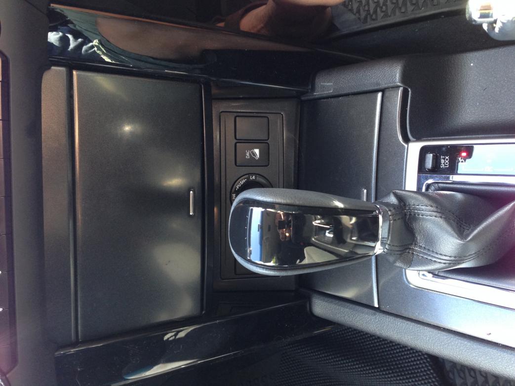

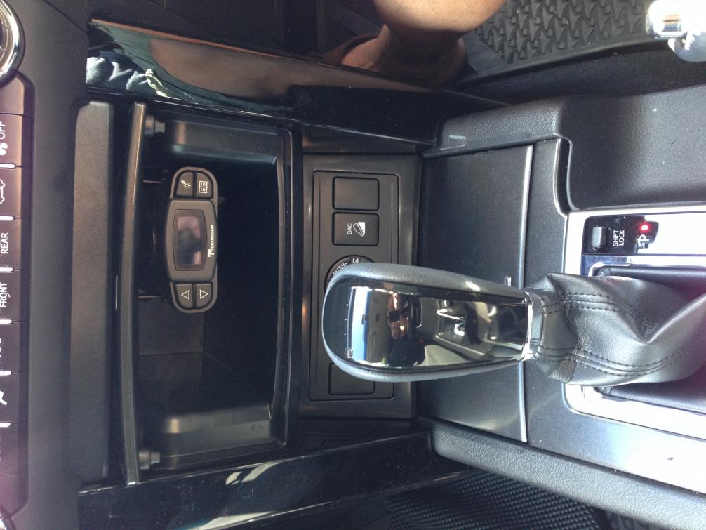

      Mine is now installed in the Facelifted GXL. It fits very neatly in the centre console and is out of sight when not needed. I took a bunch of photos of how to get everything comes apart and where the holes go etc. I'll put them up if needed. It would be a quick job...the second time around.

          I have a new GXL 150 and completed the installation of a P2 controller yesterday.
          All the colours and locations of the wires and fuse made it easy to connect.
          Used the grey wire in the LHS footwell for the power and conncted it to the brake wire in the tow bar loom at the rear.
          i located it in the same place as Dingle looks neat, close the door and it's out of site.

            I'll be installing mine where Dingle put his. I usually remove the controller from the car when not in use, so that's an awesome spot.

                    • #55
                      As for the wiring, did anyone find out if the USA Pigtail can plug into an existing loom anywhere? If so, what other items did you require?
                      Glad you like the posi MD. It's worked a treat. PM for further photos of hole locations etc if you want them.

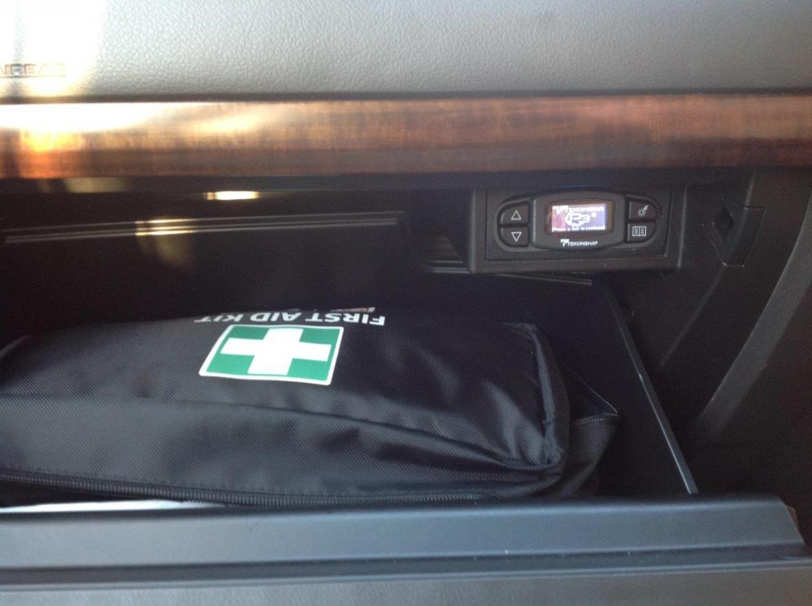

                              Hello everyone, first time post for me.
                              I joined the forum to get an insight on how to wire up and run the cable for the brake controller. It is the Tekonsha P3.
                              Thanks to all the good posters.
                              I ended up installing mine in the glove compartment, removing the pointless credit card box. I was a bit dubious as to how it would end up, and whether it ws a safe best for the operation of the brake controller. Thankfully all went well and works a treat.
                              Again, thanks to all who posted and gave me some insight in running cables and what to expect!

                              • #60
                                Nice neat fit Gaz, looks good
