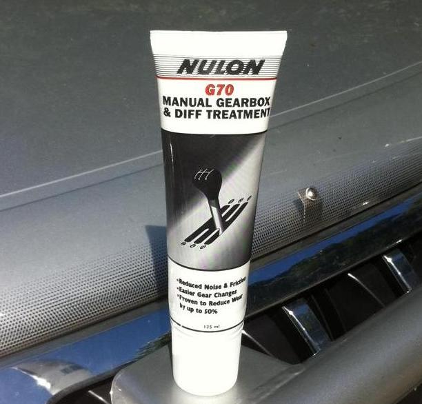

                this is what I put in my transmission, just bought it from supercheap and I think it has fixed the stiff shifter issue.....
                flyology
                  Just did a bit of googling and Castrol VMX-M is the oil recommended for 80 series transmissions. I might try that (if I am still not happy with how it is now, as I will have wasted a tube of Nulon) and see how that goes. Will try the Moreys oil stabiliser first though...
