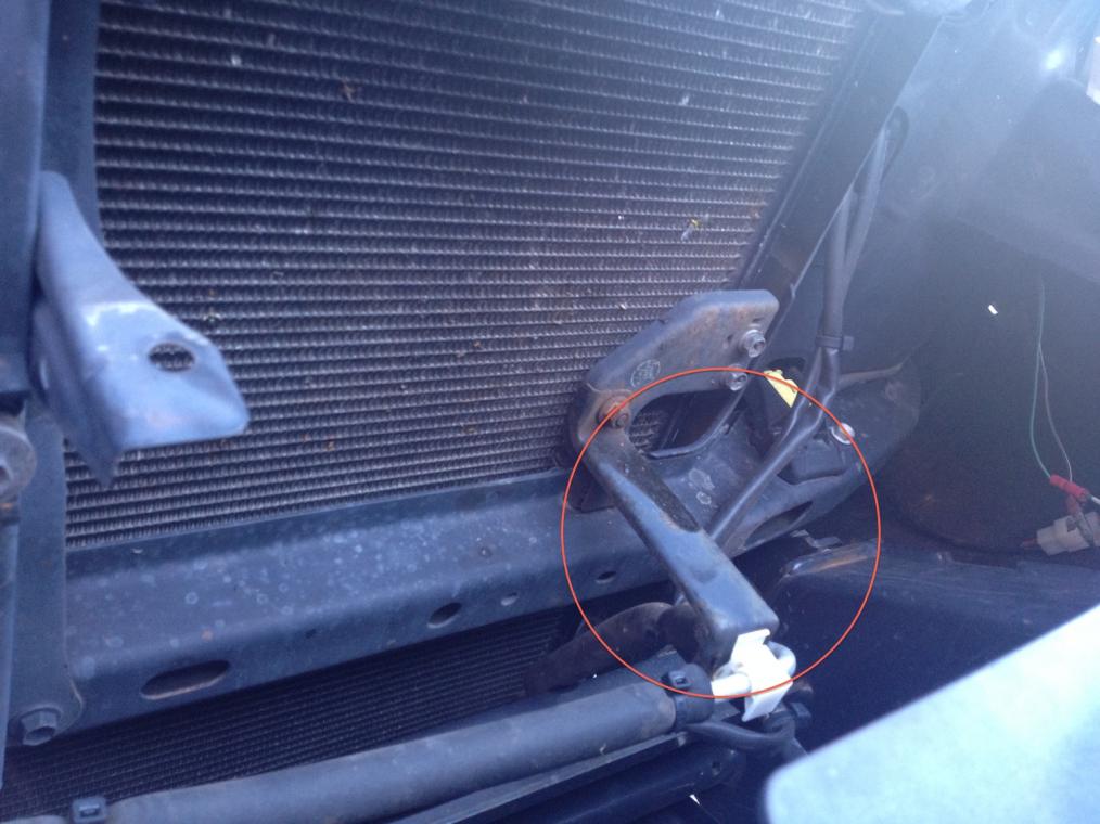

                            Dang it I've got a 120. Probably wouldn't fit mine

                              Me too. Matching your pictures with mine I thought it would be a perfect fit, but it seems That there is a bracket (circled in red) for one of the AC pipes that would foul on Tin's bracket. Do all 120s have this AC pipe bracket to anyone knowledge?
                              Any way we could get a fit up for the 120s as well, Tin?
