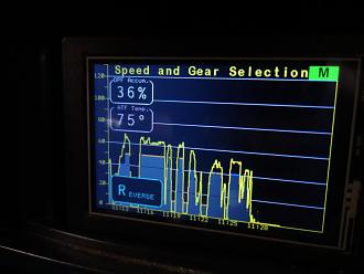

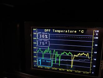

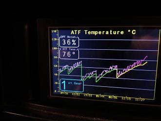

            Back in 2018 I got fed up with what was available (was in the middle of the DPF / White smoke era) and designed and built my own, which uses a 4" touchscreen and displays real-time data while I'm driving. The display sits in the storage cavity in front of the centre console. I'm in the process of revising it to interface with a 2023 GXL.
