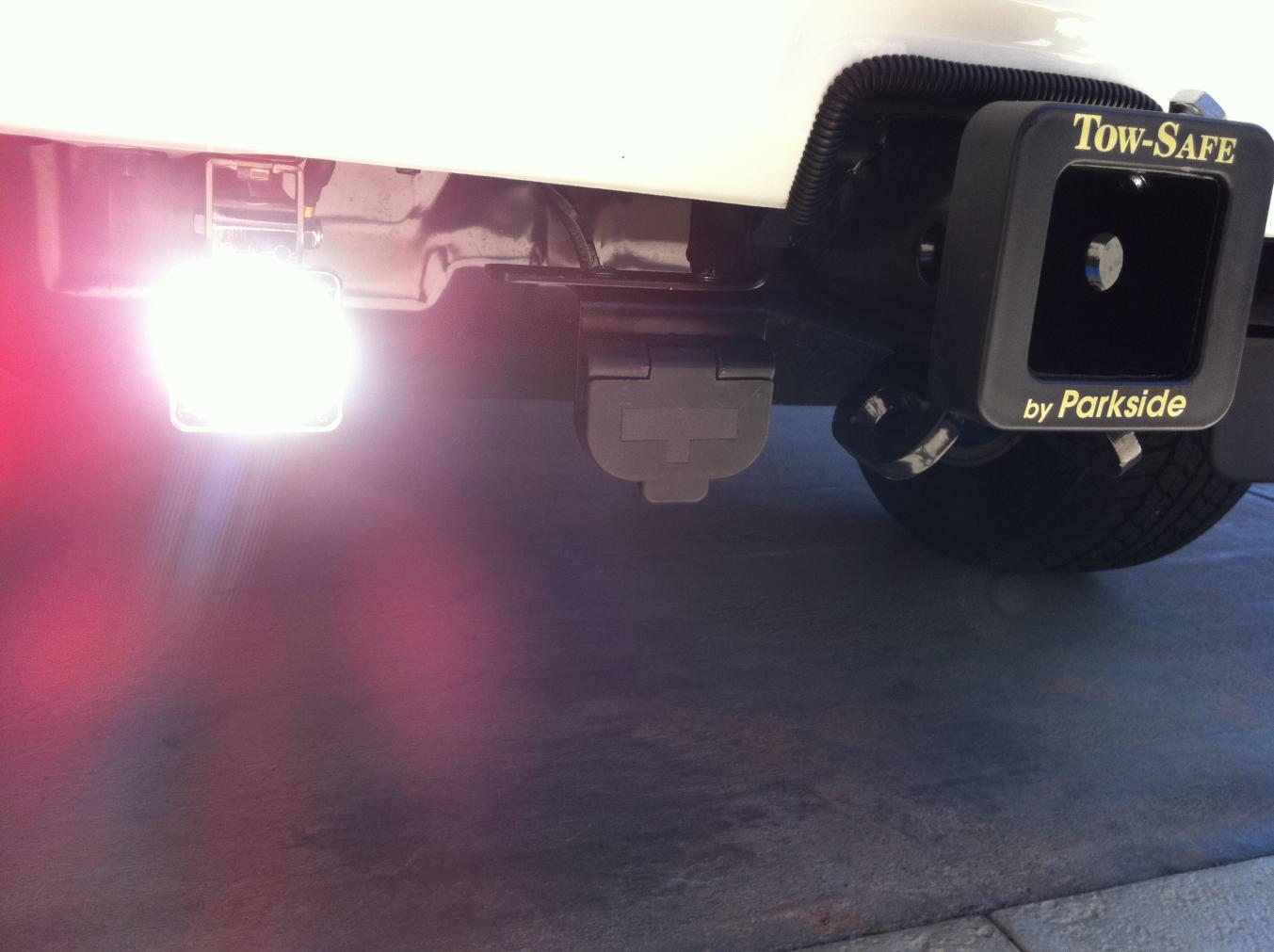

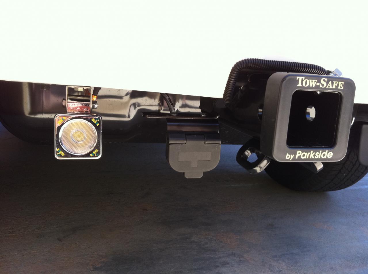

Ok i worked it out, removed the rear lamp assy, found red with blue trace wire going to reverse light and white with black trace wire for earth and tapped in. Mounted the lamp on exisiting holes next to the trailer plug. Such a bright light for such a little lamp, much brighter then most halogens. It sits higher than than the trailer plug and bar so heres hoping it doesnt get squashed on departure from steep hills. Black LED lamp cost $150 and chrome was $160 from PJL Diesel Electric you might have to haggle but tell them Scotty sent you.
