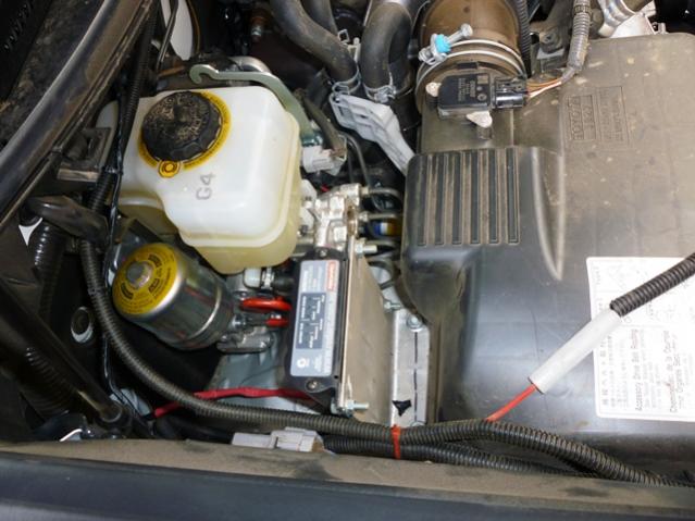

        I have a BCDC1220 mounted in my 120 series.
        I just bought a strip of metal from a big hardware store, cut and bent it to size to mount the charger on the drivers side between the air box and the firewall.
        I did it this way so I could use original bolt holes instead of drilling new holes into the guards.
        You will have to excuse the mess in the engine bay after my trip, I will have to clean that up tonight.

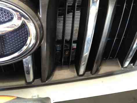

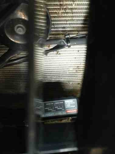

          I originally had mine bolted to the side of the second battery cradle but had dramas with it not charging properly I spoke to redarc they said it was getting too hot so I put it behind the grill haven't had a problem since Click image for larger version
ID:	641762Click image for larger version
