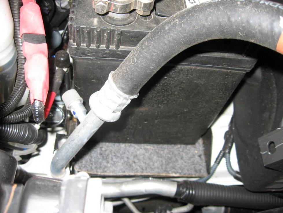

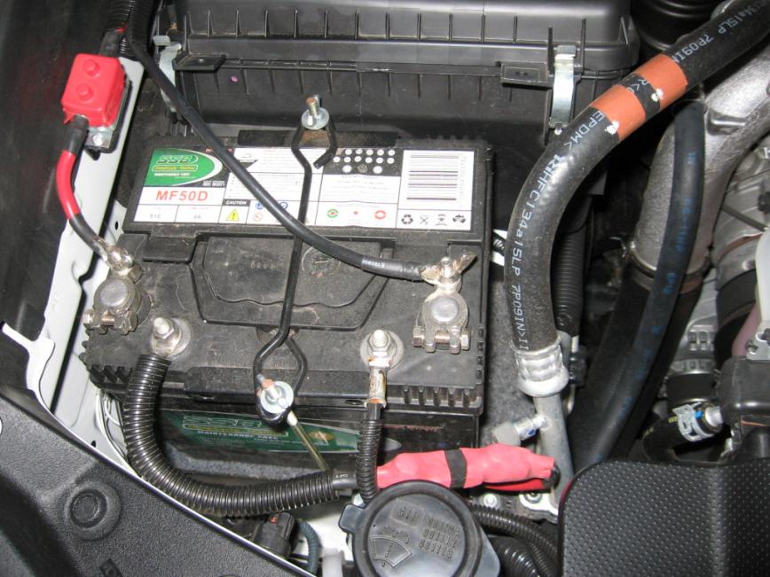

                        Didn't want to start yet another dual battery thread but have a quick question. In my 150, the battery on the passenger side (factory location) has a 12'' RACV battery sitting on a plastic tray with the clamp over it. Is this as per factory or am i missing anything for the battery to go on? It has the footing there the same as the drivers side. The reason I ask is, if that is how it came standard, why would I need to go out and spend something like $200 for a bit of tin to fit a second battery to the drivers side when I can just make a bracket to move the aircon pipe over and chuck a clamp over the battery using the holes that are already there to fit the clamp?

                            Brad,
                            I used a battery tray and holder from Super***** and cost under $50. The tray has to be slightly modified to fit and a nutsert used for bolting down. The tray accommodates a M50 battery without touching or moving air con pipe. It has been in the vehicle for over 15000km and no problems.Click image for larger version

                            Bruce
