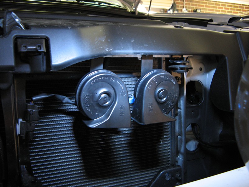

      Commondore horn (twin) is a straight swap
      Steibel if you wana scare everything within a klm
        Go the Steibel compact nautilus in parallel, you get the half second delay with the wimpy horns first then the "get the hell out of my way a*hole", took them off my 120 have haven't had a chance to fit them to the 150 yet.
          Is that the current model Commodore D4D ?? - Will I have to rejoin connectors, etc ??

            It was a few years ago but I believe they're all the same, just ask the parts guy at the local holden dealer.
            IIRC the +ve fits straight on and I made a new -ve for each. There is no relay or extra wiring required.
