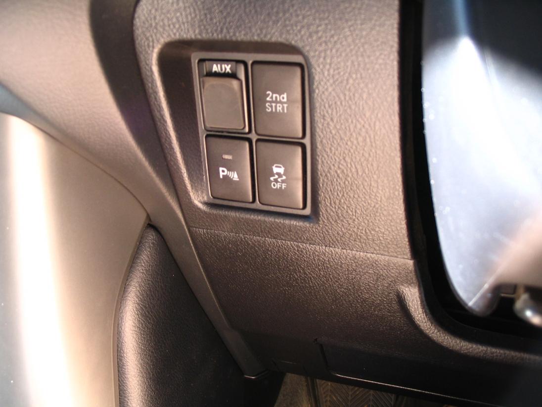

                          USB Re-Wire
                          Don't know if any one is interested or cares but it annoyed the crap out of me that Mr Tojo put the USB in the dumbest place on a 2010 Prado so I shifted it.
                          It involved taking the lid of the console and undoing the wire (There is plenty ) and repositioning it to a vertical not horizontal position were it can get full of crap.
                          Funny part is I never use it . Just annoyed me.
                          2016 ISUZU DMAX TWIN CAB.
                            Good job on the usb move, I have been looking to do the same, going to put it next to the 4wd switches in front of the gearstick. Should get it out of the way from most things when there is something plugged into it. Good to know there is some spare cord available.
